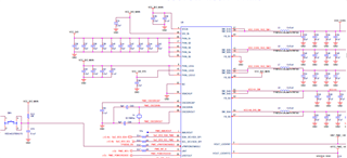

We are facing issue with processor loads high current at start up due to this PMIC hiccup and detect under voltage at 5V input.
Below is the circuit, we use 5V input at switching regulators and 3,3V to rest of power input of PMIC.
In datasheet it says Vin vs VDDA to be same or not higher than 0.5Volts difference could this cause this behavior.
When we keep Processor AM62A74AUMSIAMBRQ1 under reset condition, means removed pullup resistor connected to nRSTOUT(PIN 25) from PMIC, which connect to Processor MCU_PORZ(A7 ball), all power come good. The moment if we power on the board with nRSTOUT with pullup resistor to 1.8V(which is Buck 5 output) we run in to issue of PMIC reboot multiple times after few seconds(3 seconds) it powers off all power outputs except LDOVINT & LDOVRTC.
