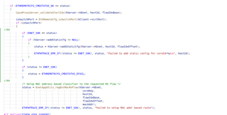

>On MCU_2_0 side, we ported the ethfw mac port changes. And on A72 side, we enabled cpsw_proxy_client driver.
We are able to ping to main interface to and from host and board (eth0).
> Now, we applied the below patch to enable VLAN.
This patch adds callbacks to ethfw for programming the static vlan.
Also changes the default vlanid 1 into 2 for internal usage.

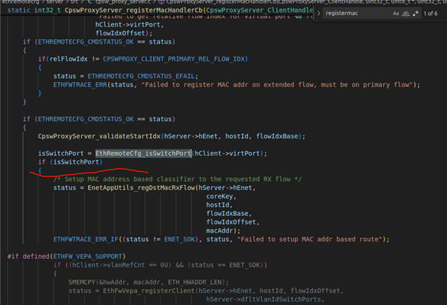

@@ -1323,6 +1329,21 @@ static int32_t CpswProxyServer_registerMacHandlerCb(CpswProxyServer_ClientHandle
                         macAddr[3U], macAddr[4U], macAddr[5U]);
+    if (ENET_SOK == status)
+        if (hServer->addStaticCfg != NULL)
+            status = hServer->addStaticCfg(hServer->hEnet, hostId, flowIdxOffset);
+            ETHFWTRACE_ERR_IF((status != ENET_SOK), status, "Failed to add static config for coreId=%u\n", hostId);
+    if (status != ENET_SOK)
+        status = ETHREMOTECFG_CMDSTATUS_EFAIL;
     return CPSWPROXY_ENET2RPMSG_ERR(status);

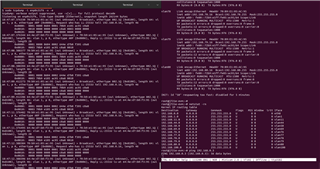

But, after adding this change, VLAN ping we are able to see but somehow main interface ping from board and host stopped.
After debugging we found that all packets going to vlan1.
Can you please help us here, what are we missing ?
Note : We are loading the mcu20 firmware from Linux.
Kishore
  • Just one more update,
    cpsw_proxy_client driver doesn't have support for VLAN.
    From SDK 9.1 on wards VLANs are static configuration at ETHFW. Client want to join VLAN need to add static Entry in ETHFW (gEthApp_vlanCfg) and request to join that VLAN from client.
    is it CPSW2G interface? If so, it should not effect because of VLAN addition.
    If eth0 is Switch port interface and eth1 is MAC only interface then it can,  If you refer to 8.1 SDK the callback for addition of static VLANs only when switch port interface is created.
    If you have not created the static entry under switch port then all VLAN packets will go to eth1.
    If you want VLAN packets to switch interface need to add static entry under switch port registration request (i.e. inside if condition shown in below).
    Can you make above change and test once.

  • Hi Sudheer,
    Thanks for your inputs.
    • is it CPSW2G interface? If so, it should not effect because of VLAN addition.
                >> It is CPSW9G.
    • If eth0 is Switch port interface and eth1 is MAC only interface then it can,  If you refer to 8.1 SDK the callback for addition of static VLANs only when switch port interface is created.>> This change is ported in our sdk.
    • Can you make above change and test once.
      >> We added static entry under switch port registration request as per your suggestions.
    But still behaviour is same.

    We followed the below steps :
    First - captured output of ifconfig -a on the target. Captured output of netstat -rn on the target. After that executed the ping. At the same time captured tcpdump output on the host.
    root@j721e-evm:~# ifconfig -a
    eth0      Link encap:Ethernet  HWaddr 70:B9:E1:05:AC:95
              inet addr:192.168.0.16  Bcast:192.168.0.255  Mask:255.255.255.0
              inet6 addr: fe80::72b9:e1ff:fe05:ac95/64 Scope:Link
              UP BROADCAST RUNNING MULTICAST  MTU:1500  Metric:1
              RX packets:7 errors:0 dropped:0 overruns:0 frame:0
              TX packets:159 errors:0 dropped:0 overruns:0 carrier:0
              collisions:0 txqueuelen:1000
              RX bytes:504 (504.0 B)  TX bytes:13006 (12.7 KiB)
    eth1      Link encap:Ethernet  HWaddr 70:B4:01:7A:E4:87
              BROADCAST MULTICAST  MTU:1500  Metric:1
              RX packets:0 errors:0 dropped:0 overruns:0 frame:0
              TX packets:0 errors:0 dropped:0 overruns:0 carrier:0
              RX bytes:0 (0.0 B)  TX bytes:0 (0.0 B)
    lo        Link encap:Local Loopback
              inet addr:127.0.0.1  Mask:255.0.0.0
              inet6 addr: ::1/128 Scope:Host
              UP LOOPBACK RUNNING  MTU:65536  Metric:1
              RX packets:2 errors:0 dropped:0 overruns:0 frame:0
              TX packets:2 errors:0 dropped:0 overruns:0 carrier:0
              RX bytes:224 (224.0 B)  TX bytes:224 (224.0 B)
    mcu_mcan0 Link encap:UNSPEC  HWaddr 00-00-00-00-00-00-00-00-00-00-00-00-00-00-00-00
              NOARP  MTU:16  Metric:1
              Interrupt:116
    vlan1     Link encap:Ethernet  HWaddr 70:B9:E1:05:AC:95
              inet addr:192.168.1.16  Bcast:192.168.1.255  Mask:255.255.255.0
              UP BROADCAST RUNNING MULTICAST  MTU:1490  Metric:1
              TX packets:14 errors:0 dropped:0 overruns:0 carrier:0
              RX bytes:378 (378.0 B)  TX bytes:1076 (1.0 KiB)
    vlan100   Link encap:Ethernet  HWaddr 70:B9:E1:05:AC:95
              inet addr:192.168.100.16  Bcast:192.168.100.255  Mask:255.255.255.0
              TX packets:12 errors:0 dropped:0 overruns:0 carrier:0
              RX bytes:0 (0.0 B)  TX bytes:976 (976.0 B)
    vlan11    Link encap:Ethernet  HWaddr 70:B9:E1:05:AC:95
              inet addr:192.168.11.16  Bcast:192.168.11.255  Mask:255.255.255.0
    vlan44    Link encap:Ethernet  HWaddr 70:B9:E1:05:AC:95
              inet addr:192.168.44.16  Bcast:192.168.44.255  Mask:255.255.255.0
    vlan50    Link encap:Ethernet  HWaddr 70:B9:E1:05:AC:95
              inet addr:192.168.50.16  Bcast:192.168.50.255  Mask:255.255.255.0
    vlan69    Link encap:Ethernet  HWaddr 70:B9:E1:05:AC:95
              inet addr:192.168.69.16  Bcast:192.168.69.255  Mask:255.255.255.0
    vlan76    Link encap:Ethernet  HWaddr 70:B9:E1:05:AC:95
              inet addr:192.168.76.16  Bcast:192.168.76.255  Mask:255.255.255.0
    vlan77    Link encap:Ethernet  HWaddr 70:B9:E1:05:AC:95
              inet addr:192.168.77.16  Bcast:192.168.77.255  Mask:255.255.255.0
    vlan78    Link encap:Ethernet  HWaddr 70:B9:E1:05:AC:95
              inet addr:192.168.78.16  Bcast:192.168.78.255  Mask:255.255.255.0
    vlan79    Link encap:Ethernet  HWaddr 70:B9:E1:05:AC:95
              inet addr:192.168.79.16  Bcast:192.168.79.255  Mask:255.255.255.0
    vlan80    Link encap:Ethernet  HWaddr 70:B9:E1:05:AC:95
              inet addr:192.168.80.16  Bcast:192.168.80.255  Mask:255.255.255.0
    INIT: Id "S0" respawning too fast: disabled for 5 minutes
    root@j721e-evm:~#
    root@j721e-evm:~# netstat -rn
    Kernel IP routing table
    Destination     Gateway         Genmask         Flags   MSS Window  irtt Iface
    192.168.0.0     0.0.0.0         255.255.255.0   U         0 0          0 eth0
    192.168.1.0     0.0.0.0         255.255.255.0   U         0 0          0 vlan1
    192.168.11.0    0.0.0.0         255.255.255.0   U         0 0          0 vlan11
    192.168.44.0    0.0.0.0         255.255.255.0   U         0 0          0 vlan44
    192.168.50.0    0.0.0.0         255.255.255.0   U         0 0          0 vlan50
    192.168.69.0    0.0.0.0         255.255.255.0   U         0 0          0 vlan69
    192.168.76.0    0.0.0.0         255.255.255.0   U         0 0          0 vlan76
    192.168.77.0    0.0.0.0         255.255.255.0   U         0 0          0 vlan77
    192.168.78.0    0.0.0.0         255.255.255.0   U         0 0          0 vlan78
    192.168.79.0    0.0.0.0         255.255.255.0   U         0 0          0 vlan79
    192.168.80.0    0.0.0.0         255.255.255.0   U         0 0          0 vlan80
    192.168.100.0   0.0.0.0         255.255.255.0   U         0 0          0 vlan100

    From ETHFW log & tcpdump data it seems ARP request for Multicast Mac/Multicast IP
    f4:8b vlanId=65535 flowIdx=172,0
    [MCU2_0]      9.920867 s: ETHFW: ADD_FILTER_MAC | S2C | status=0
    [MCU2_0]      9.938647 s: ETHFW: EthFwArp_addAddr: mcast IP address cannot be added: -3
    ETHFW can't support Multicast MAC IPv4 assignment & even Multicast IPv4 registration.
    You can do one thing, Disable PROXY ARP and eable Inter-core Virtual Ethernet communication. It allows clients to receive the Broadcast MAC address.
    So, client it self response to ARP request.
    https://software-dl.ti.com/jacinto7/esd/processor-sdk-rtos-jacinto7/latest/exports/docs/ethfw/docs/user_guide/ethfw_c_ug_top.html#ethfw_intercore_eth
    By referring below, create TAP interface on Linux. via TAP Linux will receive Broadcast packets.
    https://software-dl.ti.com/jacinto7/esd/processor-sdk-rtos-jacinto7/latest/exports/docs/ethfw/docs/user_guide/demo_ethfw_combined_top.html#ethfw_intercore_communication
