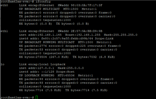

    I was able to get the SD card to fully boot but the ethernet is not getting set up properly.  The USB still works and our SPI test code still works.  Any thoughts?
    Here's the boot log:

    The log doesn't show how the ethernet is not set up properly. please explain. the boot log shows eth1 is up though:
    [   13.945910] am65-cpsw-nuss 8000000.ethernet eth1: Link is Up - 1Gbps/Full - flow control rx/tx
  • I think it need to show a specific driver, otherwise it doesn't work properly:
    No IP address on eth1:
  • ethernet is not in my support scope, so I barely touch it and am not sure if dhcpc server automatically starts in the base- filesystem to get an IP address from a dhcp server.
    If you manually assign an IP address on eth1, can you ping other device on the same network?
