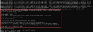

Hi TI expert
We use gmake tool to build our AM62Ax project in windows operation system,
sometimes the compiler report error log as the screenshot show,but if
we try to rebuild the project more times then it can build successfully and generate
useful appimage.hs_fs files.
so what can i do to resolve this problem.

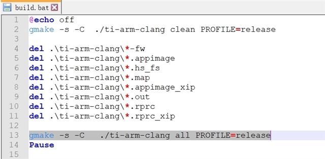

           SDK version is  V9.2;
          We  use a bat script file to  run the gmake command like this:    " gmake -s -C ./ti-arm-clang all                PROFILE=release";
          the build.bat  script file location is  "D:\DAF_DMS\DAF_DSM_ECU_MCU";
           the screenshot below shows the script file content;

  • Hi Ming,
    When we run gmake -s -C command we provide the full path to the example folder for which binaries needs to be build.
    In your script I can only see gmake -s -C ./ti-arm-clang.
    Can you please tell which binary it will build if I run the above command?
    Are you running this from SDK root directory?
    Tushar

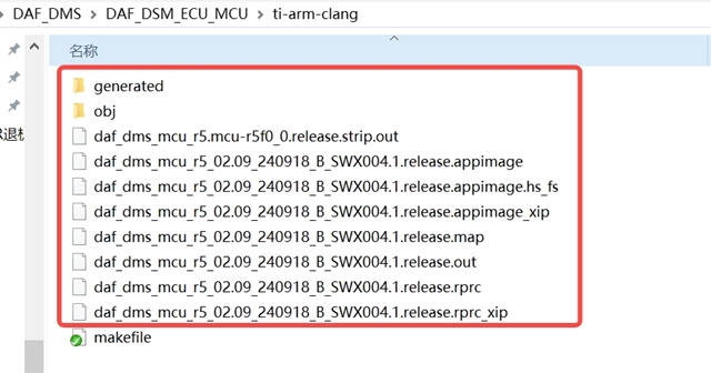

  • hi  Thakur
           if  the project build  successfully,  some app image  file and  obj file  will be generated,  these files are  show as the screenshot show ,
           the source file  to be  build  are  listed in the makefile  file ;
           the project is not SDK example  but ported from SDK  IPC example  and is located   in D:\DAF_DMS\DAF_DSM_ECU_MCU in my computer

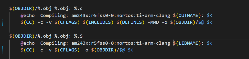

  • Hi Ming,
    Can you please try adding the -v option in the compilation command to get detailed error logs as suggested in above error message?
    Please refer below image.
    Tushar
