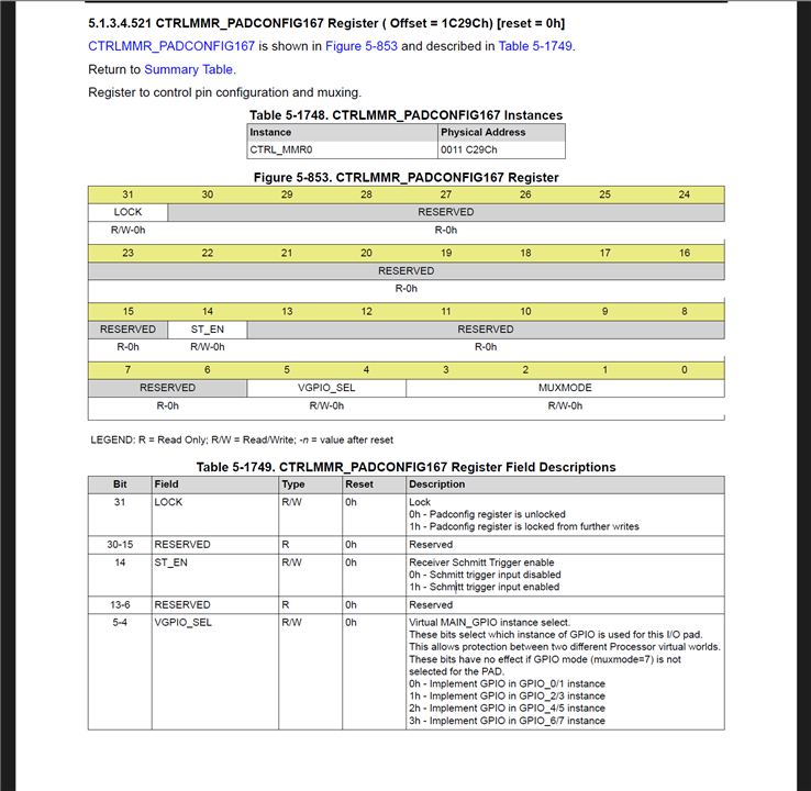

The pinmux is already configured to GPIO1_32
root@j7-evm:~# cat /sys/kernel/debug/pinctrl/11c000.pinctrl-pinctrl-single/pins | grep 11c29c
pin 167 (PIN167) 0:? 11c29c 00000007 pinctrl-single
root@j7-evm:~# cat /sys/kernel/debug/pinctrl/11c000.pinctrl-pinctrl-single/pinmux-pins | grep 167
pin 167 (PIN167): nvidia-ctl-gpios (GPIO UNCLAIMED) function nvctl-main-pins-default group nvctl-main-pins-default
The GPIO1_32 cannot be set to high or low by write reg,we measured the voltage and it remained around 0.6v

  • We are using TDA4VM-Q1, the sdk version is "ti-processor-sdk-linux-j7-evm-08_06_01_02", we have encountered a problem,when we configure the AC23 BALL to GPIO1_32 pinmux mode, it cannot be set to high or low output.
    Data Sheet: https://www.ti.com/lit/ds/symlink/tda4vm.pdf?ts=1730083313173&ref_url=https%253A%252F%252Fwww.ti.com%252Fproduct%252FTDA4VM
    The ball AC23 does not map to GPIO1_32.
    AC3 maps to
    So can you check the value of 0x00011C2A0? Using devmem2 in Linux or md command in U-Boot.
    - Keerthy
  • sorry,i typed wrong,the ball is AC3.
    root@j7-evm:~# devmem2 0x00011C2A0
    /dev/mem opened.
    Memory mapped at address 0xffffb2008000.
    Read at address  0x0011C2A0 (0xffffb20082a0): 0x00000007
    root@j7-evm:~# devmem2 0x00011C29c
    /dev/mem opened.
    Memory mapped at address 0xffffa351a000.
    Read at address  0x0011C29C (0xffffa351a29c): 0x00000007
  • Okay. Understood.
    Please try below:
    devmem2 0x00011C2A0 w 0x40007
    The bit18 needs to be set to physically change the state of GPIO pins.
    - Keerthy
  • Addr "0x00011C2A0" is mapped to "PADCONFIG168", AC3 is map to "PADCONFIG167", does it correct?
    /dev/mem opened.
    Memory mapped at address 0xffffbac9e000.
    Read at address  0x0011C2A0 (0xffffbac9e2a0): 0x00000007
    root@j7-evm:~# devmem2 0x00011C2A0 w 0x40007
    /dev/mem opened.
    Memory mapped at address 0xffffa1876000.
    Read at address  0x0011C2A0 (0xffffa18762a0): 0x00000007
    Write at address 0x0011C2A0 (0xffffa18762a0): 0x00040007, readback 0x00040007
    root@j7-evm:~# devmem2 0x00011C29C
    /dev/mem opened.
    Memory mapped at address 0xffff971c7000.
    Read at address  0x0011C29C (0xffff971c729c): 0x00000007
    root@j7-evm:~# devmem2 0x00011C29C w 0x40007
    /dev/mem opened.
    Memory mapped at address 0xffffa34ea000.
    Read at address  0x0011C29C (0xffffa34ea29c): 0x00000007
    Write at address 0x0011C29C (0xffffa34ea29c): 0x00040007, readback 0x00040007
    root@j7-evm:~# devmem2 0x00601044 w 0x03
    /dev/mem opened.
    Memory mapped at address 0xffff9c65d000.
    Read at address  0x00601044 (0xffff9c65d044): 0x00000001
    Write at address 0x00601044 (0xffff9c65d044): 0x00000003, readback 0x00000003
    root@j7-evm:~# devmem2 0x00601040 w 0x01
    /dev/mem opened.
    Memory mapped at address 0xffff9590e000.
    Read at address  0x00601040 (0xffff9590e040): 0x00000000
    Write at address 0x00601040 (0xffff9590e040): 0x00000001, readback 0x00000001
  • Are you able to see the physical toggle now with 0x40007 written to:
    - Keerthy
  • The bit18 needs to be set to physically change the state of GPIO pins.
    These pads are different.
    So bit18 is a don't care / reserved.
    So setting the GPIO mode is good enough.
    Looping in our HW expert.
    - Keerthy
  • root@j7-evm:~# devmem2 0x11c29c
    /dev/mem opened.
    Memory mapped at address 0xffff9db56000.
    Read at address  0x0011C29C (0xffff9db5629c): 0x00000007
    The register value seems like normal, but when i measured the physical voltage,it has always been 0.68V.
    BTW, this issue occurred during the migration of the 08_06 version SDK, while the original 08_00 version SDK had no problem.
  • Are you using TI's EVM, TI's Starter Kit, or custom hardware?  The 0.68V is certainly not a normal voltage for a digital signal level.
  • We use custom hardware, the same board has issues with the SDK in version 08_06, but there are no issues with the SDK in version 08_00,and the GPIO1_33 has the same issue.
  • Can you clarify the connection on the custom board?  What external circuitry is connected to this pin?
