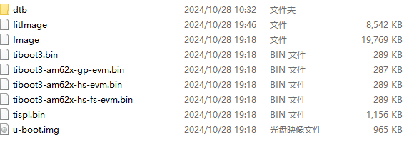

  • Hi Andreas
        I m not using the SD card mode to boot; I am using DFU tool to flash in emmc and boot from eMMC mode
       PS:No sdcard
    Thanks.
    Oliver
  • DId i missing something in kernel compilation?
  •   I m not using the SD card mode to boot; I am using DFU tool to flash in emmc and boot from eMMC mode

  • Well thanks a lot Andreas

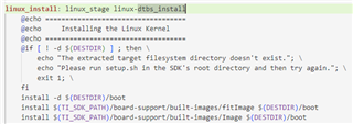

        Also Do you know the DESTDIR default generated path, or can you show me your entire DESTDIR path?
  • Why is the lib directory missing the modules folder when I boot from mmc?
    How are you preparing the image for flashing to eMMC?
  • Hi Prashant
     Thanks for your help,this is my preparing script
  • this is my preparing script
    That is just a snapshot of the default makefile.
    I would like to know what exact rootfs image you have flashed to eMMC over DFU & how did you get that image?

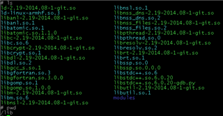

  • Hi Prashant
     i ve already found the modules folder,but no mod is running as result of "lsmod"
  •  i ve already found the modules folder,but no mod is running as result of "lsmod"
    Can you please share the output of the following commands:
    => cat /proc/version
    => ls /lib/modules
    Thanks!
    The Kernel version matches with the modules. So, that's good. Are you sure the `lsmod` doesn't show anything? If it doesn't, can you share the full Kernel logs.
    Are there any modules present in the folder? How did you get the folder which was missing earlier?
    Please share the output of the following command
    => cd /lib/modules
    => find -type f
    Please attach the logs using "Insert -> Code" feature for better readability.
    Thanks!
