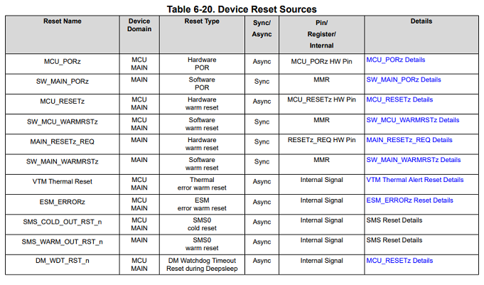

How does the reboot command on Linux reboot HW?
What steps does the reboot command perform?
Our customer is using PSDK Linux 08.06.00.42 and eMMC boot by the reboot command fails on their custom board. They want to know it for debugging.
By the way, SD card boot by the reboot command works fine on their custom board. SD card boot and eMMC boot by the reboot command works fine on SK EVM board.
If the AM62x is reset by the reboot command, which reset source is used?
