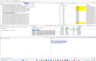

    Please find the attached image of Mcu UART terminal, we have an error as part of SBL boot
    dslite.bat --mode processors -c COM22 -f C:\ti\uniflash_8.8.0\processors\FlashWriter\j721e_evm\uart_j721e_evm_flash_programmer_release.tiimage -i 0
    dslite.bat --mode processors -c COM22 -f C:\Pradeep\PradeepR_272723\TI\TDA4\J721E\ti-processor-sdk-rtos-j721e-evm-09_00_00_02\pdk_jacinto_09_00_00_45\packages\ti\boot\sbl\binary\j721e_evm\ospi\bin\sbl_ospi_img_mcu1_0_release.tiimage -d 3 -o 0
    dslite.bat --mode processors -c COM22 -f C:\Pradeep\PradeepR_272723\TI\TDA4\J721E\ti-processor-sdk-rtos-j721e-evm-09_00_00_02\pdk_jacinto_09_00_00_45\packages\ti\drv\sciclient\soc\V1\tifs.bin -d 3 -o 80000
    dslite.bat --mode processors -c COM22 -f C:\Pradeep\PradeepR_272723\TI\TDA4\J721E\udma_memcpy_testapp_freertos\bin\j721e_evm\udma_memcpy_testapp_freertos_mcu1_0_release.appimage -d 3 -o 100000
    dslite.bat --mode processors -c COM22 -f C:\Pradeep\PradeepR_272723\TI\TDA4\J721E\ti-processor-sdk-rtos-j721e-evm-09_00_00_02\pdk_jacinto_09_00_00_45\packages\ti\board\src\flash\nor\ospi\nor_spi_patterns.bin -d 3 -o 3FE0000
    we downloaded the udma_memcpy_testapp_freertos from one of the TI E2E ticket, we did not get this example as part of SDK
    Pradeep R

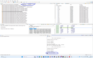

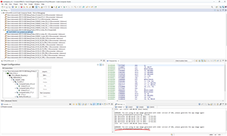

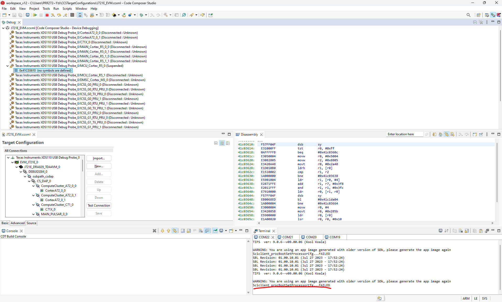

  • Hello Karthik,
    As shown below, when we boot from flash, we are getting below error
    when we debugged we found that the DDR region is not enabled by SBL, so can you please provide us an SBL imiage that boots Mcu domain and enables DDR region and copies application into DDR region for execution
    Currently we are using
    All the above images were already prebuilt in SDK
    Our need is, we will develop our application in DDR region and when boot the TDAVM device from flash, the TI SBL should copy the application from flash into DDR region and execute the application
    Pradeep R

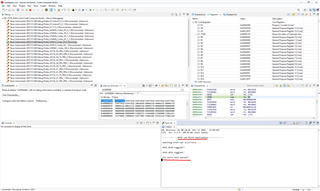

  • Hello karthik,
    Thankyou for the images, now i can see that control is in application
    To proceed further, i want to know the linker file used to build this application GPIO_Baremetal_LedBlink_TestApp_mcu1_0_release.appimage, can you please share us the memory usage or linker file of this application so that we build our application similar to this.
    I have two more queries
    1 when we do system reset in CCS, application runs properly
    2 When we do CPU reset in CCS, it gets stucks at one point
    Can you please explain this behaviour
    Thankyou
    Pradeep R

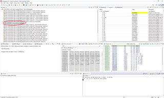

  • Hello karthik,
    Even after adapting the linker as per provided reference , we are getting issue in running application. Please find the linker and map fileTDA4XEVM.zip
    Our application is Stuck at the Exception Handler
    Also may i know in the provided SBL ti image as part of this (J721e_EVM_9.2_WorkingSample.zip) whether the option "DSBL_SKIP_MCU_RESET" is enabled or not
    Because as per our debugging the exception handler is triggered because of MCU reset.
    If  in case not enabled, can you please enable and provide us the SBL ti image, we will verify it once
    Pradeep R
    Please refer the sbl_cust_img which you can control the following things
    • DDR initialization
    • Initialization of PLLs
    • Initialization of clocks
    • Skipping MCU Reset
    Karthik
  • Hello Karthik,
    with cust sbl image it is working for us as i mentioned earlier, the OSPI SBL  image is not working
