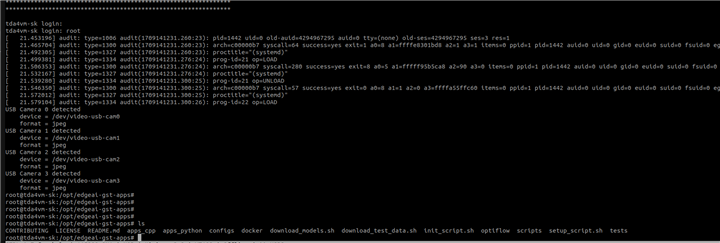

I am using the stock Image provided at https://dr-download.ti.com/software-development/software-development-kit-sdk/MD-4K6R4tqhZI/10.00.00.08/tisdk-edgeai-image-j721e-evm.wic.xz flashed on a 16GB MicroSD card, and for testing the boot behavior, on another 64GB card. One image was flashed with BalenaEtcher tool and the second one with bmap-tools.
Everytime I power-on the SK-TDA4VM board, I get the following message a few times, before booting successfully:
U-Boot SPL 2024.04-ti-g818c76aed67f (Aug 01 2024 - 19:19:47 +0000)
SYSFW ABI: 4.0 (firmware rev 0x000a '10.0.8--v10.00.08 (Fiery Fox)')
Trying to boot from MMC2
spl_load_image_fat: error reading image tispl.bin, err - -22
spl_load_image_ext: ext4fs mount err - 0
SPL: failed to boot from all boot devices
### ERROR ### Please RESET the board ###
Then after running for a while a message with kernel panic is shown and I have to reset the board. Sometimes the board reboots automatically.
Automatic reboot

root@tda4vm-sk:/opt/edgeai-gst-apps#

tda4vm-sk login: [   17.251388] usb 1-1.1: Found UVC 1.00 device Logitech Webcam C930e (046d:0843)
root
[   21.129391] kauditd_printk_skb: 8 callbacks suppressed
[   21.129398] audit: type=1006 audit(1730267264.525:16): pid=1316 uid=0 old-auid=4294967295 auid=0 tty=(none) old
-ses=4294967295 ses=3 res=1
[   21.147407] audit: type=1300 audit(1730267264.525:16): arch=c00000b7 syscall=64 success=yes exit=1 a0=8 a1=ffff
f3adb4f8 a2=1 a3=1 items=0 ppid=1 pid=1316 auid=0 uid=0 gid=0 euid=0 suid=0 fsuid=0 egid=0 sgid=0 fsgid=0 tty=(non
e) ses=3 comm="(systemd)" exe="/usr/lib/systemd/systemd-executor" key=(null)
[   21.174242] audit: type=1327 audit(1730267264.525:16): proctitle="(systemd)"
[   21.181696] audit: type=1334 audit(1730267264.533:17): prog-id=18 op=LOAD
[   21.188806] audit: type=1300 audit(1730267264.533:17): arch=c00000b7 syscall=280 success=yes exit=8 a0=5 a1=fff
fddff12f8 a2=90 a3=0 items=0 ppid=1 pid=1316 auid=0 uid=0 gid=0 euid=0 suid=0 fsuid=0 egid=0 sgid=0 fsgid=0 tty=(n
one) ses=3 comm="systemd" exe="/usr/lib/systemd/systemd" key=(null)
[   21.214809] audit: type=1327 audit(1730267264.533:17): proctitle="(systemd)"
[   21.222220] audit: type=1334 audit(1730267264.545:18): prog-id=18 op=UNLOAD
[   21.229436] audit: type=1300 audit(1730267264.545:18): arch=c00000b7 syscall=57 success=yes exit=0 a0=8 a1=1 a2
=0 a3=ffff9617fc60 items=0 ppid=1 pid=1316 auid=0 uid=0 gid=0 euid=0 suid=0 fsuid=0 egid=0 sgid=0 fsgid=0 tty=(non
[   21.255179] audit: type=1327 audit(1730267264.545:18): proctitle="(systemd)"
[   21.262411] audit: type=1334 audit(1730267264.545:19): prog-id=19 op=LOAD
USB Camera 0 detected
    device = /dev/video-usb-cam0
    format = jpeg
USB Camera 1 detected
    device = /dev/video-usb-cam1
    format = jpeg
        format = jpeg
        format = jpeg
    root@tda4vm-sk:/opt/edgeai-gst-apps# [  213.103590] Unable to handle kernel paging request at virtual address ff8a00082cffe8c0
    after running the reboot command and logging in the error happened again.
        format = jpeg
        format = jpeg
    root@tda4vm-sk:/opt/edgeai-gst-apps# [   72.929332] Unable to handle kernel paging request at virtual address 004cfbffef914768
    [   72.937240] Mem abort info:
    [   72.939315] Unable to handle kernel paging request at virtual address ffff800081ff2130
    [   72.940021]   ESR = 0x0000000096000004
    [   72.947915] Mem abort info:
    [   72.951647]   EC = 0x25: DABT (current EL), IL = 32 bits
    [   72.954424]   ESR = 0x0000000096000007
    [   72.959715]   SET = 0, FnV = 0
    [   72.963447]   EC = 0x25: DABT (current EL), IL = 32 bits
    [   72.966486]   EA = 0, S1PTW = 0
    [   72.971778]   SET = 0, FnV = 0
    [   72.974902]   FSC = 0x04: level 0 translation fault
    [   72.977941]   EA = 0, S1PTW = 0
    [   72.982800] Data abort info:
    [   72.985924]   FSC = 0x07: level 3 translation fault
    [   72.988789]   ISV = 0, ISS = 0x00000004, ISS2 = 0x00000000
    [   72.993648] Data abort info:
    [   72.999113]   CM = 0, WnR = 0, TnD = 0, TagAccess = 0
    [   73.001979]   ISV = 0, ISS = 0x00000007, ISS2 = 0x00000000
    [   73.007011]   GCS = 0, Overlay = 0, DirtyBit = 0, Xs = 0
    [   73.012476]   CM = 0, WnR = 0, TnD = 0, TagAccess = 0
    [   73.017767] [004cfbffef914768] address between user and kernel address ranges
    [   73.022799]   GCS = 0, Overlay = 0, DirtyBit = 0, Xs = 0
    [   73.029913] Internal error: Oops: 0000000096000004 [#1] PREEMPT SMP
    [   73.035204] swapper pgtable: 4k pages, 48-bit VAs, pgdp=0000000082ff1000
