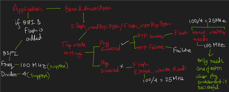

  • Where is the Phy enabled and disabled throughout the MCU PLUS SDK code offering?
    In the MCU PLUS SDK, when you start development, you would come across different APIs for different peripherals and protocols.
    The usual flow is as follows:
    To look at a sample easy to understand flow, please check this: https://github.com/TexasInstruments/mcupsdk-core/blob/next/examples/hello_world/hello_world.c
    Now in SysConfig when:
    1. OSPI is added
    2. Flash is added
    3. Under OSPI:
      1. Phy mode is enabled and checked.
    Then at step 2: Board_driversOpen() if you step inside the code then you would eventually find that:
    1. For NAND flash part: the flow goes to flash_nand_ospi.c and the API Flash_nandOspiOpen() is called. In this case, the API OSPI_phyTuneSDR() or OSPI_phyTuneDDR() is called based on the protocol SDR/DDR selected.
    2. For NOR flash part: the flow goes to flash_nor_ospi.c and the API Flash_norOspiOpen() is called. In this case the API OSPI_phyTuneSDR() or OSPI_phyTuneDDR() is called based on the protocol SDR/DDR selected.
    A: Inside OSPI_phyTuneDDR, OSPI_phyFindOTP1 computes the optimal tuning point(OTP)
    B: Inside OSPI_phyTuneSDR, OSPI_phyFindOTP3 computes the optimal tuning point(OTP)
    Note inside APIs A and B the flow is as follows:
    The next time Phy is enabled is when the API Flash_read() is called.
    If you step inside Flash_read() the flow comes to a point as follows:
    So, when the Phy is enabled, the read happens at a clock frequency of 166 MHz as the clock divider value is bypassed and then the Phy is disabled.
