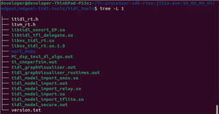

In /opt folder, I installed several edgeai modules such as tidl_tools :
I installed it from the git repository  : GitHub - TexasInstruments/edgeai-tidl-tools: Edgeai TIDL Tools and Examples - This repository contains Tools and example developed for Deep learning runtime (DLRT) offering provided by TI’s edge AI solutions.
Then, I tried to solve the problem with "export" to add TIDL_TOOLS_PATH to environment variable but it didn't work :

  • Here are some steps to solve this problem:
    First, I was attempting to compile the Edge AI model on the EVM, whereas inference can only be run on the EVM.
    Secondly, if you encounter the error "TIDL_TOOLS_PATH is not found" for any other reason, please verify that the TIDL tools setup is completed correctly. If you are working offline, open edgeai_tidl_tools/setup.sh and perform the setup manually.
    Azer

    I changed my configuration but I'm still getting the same error. I'm on Ubuntu 22.04 with Python 3.10 and I'm using the latest version of SDK 10_00_00_05. I followed the steps from the Vision Apps tutorial:
    https://software-dl.ti.com/jacinto7/esd/processor-sdk-rtos-jacinto7/10_00_00_05/exports/docs/vision_apps/docs/user_guide/index.html
    Then, I installed edgeai-benchmark and edgeai-tidl-tools following their setup instructions:
    https://github.com/TexasInstruments/edgeai-tidl-tools/tree/10_00_08_00?tab=readme-ov-file#compile-and-benchmark-custom-model

    So now my PSDK RTOS looks like that :
    However, I noticed that in PSDK RTOS, an other tidl_tools directory exists with broken links :
    So, when running custom model compilation, I get the error 'TIDL_TOOLS_PATH not found' even though it is present in my environment variables (I checked with $TIDL_TOOLS_PATH). I therefore wrote the path of the folder directly:
    Then, using Visual Studio, I run a custom-model-tfl.ipynb and when I run this code :
    I am getting this error: "could not load library libvx_tidl_rt.so"
    What is the problem? How can I fix it?
    So with this configuration, I try to run custom model compilation
    Then, I get the error 'TIDL_TOOLS_PATH not found' even though it is present in my environment variables (I checked with $TIDL_TOOLS_PATH). I therefore wrote the path of the folder directly:
