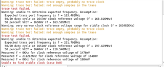

On SDK 9 Linux, I was able to perform an offchip trace on R5F or C7X cores using Lauterbach’s TRACE32, Linux running on A72 cores.
On SDK 10, using the same scripts, it is no longer working. The autofocus fails with the following messages (launched two times):
I suspect the problem comes from Linux, since using SDK 9’s u-boot to network boot on SDK 10’s Linux leads to the same problem.
Has there been any changes to Linux drivers or device trees that could have caused this?
Lucas
  • Please be aware, that assigned TI resource is out of office for the rest of this week, a delay in response may occur.
    kb
    It seems something has either mux'ed away the external trace clock or shut it off in the code flow you are using.  You should attach and verify the settings of the clock and pins.
    Use the addresses found in the external trace file:  /cfs-file/__key/communityserver-discussions-components-files/791/J784S4_5F00_offchip_5F00_trace.cmm for example the trace clock source is here: ZAXI:0x68208C and the trace clock itself is here: ZAXI:0x0011C0C8.
    Linux in some boot flows might use a DT or DT overlay which sets up to support an external daughter card.   In flows which provisioning for that board it will change the mux away from your control.
    Taking back the SOC level mux is easy as long as nothing is 're-asking' for it.  What is a little harder to deal with on the EVM is there is a GPIO expander which has a hardware 'FET MUX' which routes the physical signals to a expansion header instead of to the trace header.  to fix this you need to alter the DT which is controlling the FET mux.  If you find the below you can fix it.  The DT or an override can make it confusing to know if you changed the correct one.  What I do here, is use TRACE32's Linux awareness and you can see in the in-memory DT which is in use.   This will let you check to see if your fix was in the right place.  You can rebuild the DTS and place the file in the filesystem or you can hack and probably binary edit it before it gets consumed.  I used to hit this issue when using vision sdk packages.  Of course its possible some driver at run time made a change with a direct I2C write to the expander (which you could also do via the command line) but that would be cheating as this shared resource instance should be coordinated through DT.

    Richard W.
    Thank you for your response!
    Removing both p13-hog and p15-hog from exp2: gpio@22 in k3-j784s4-evm.dts solved my issue.
