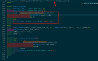

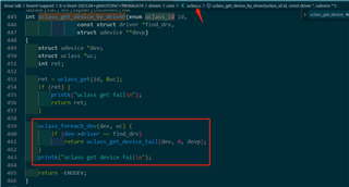

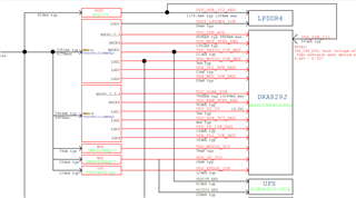

  • Hi Keerthy,
    Which PMIC is being used?
    The PMIC-A and PMIC-B are  TPS6594x
    However, according to our hardware engineers, they disabled ESM functionality in hardware.
    It's not clear to me if this is one of the reasons for the init error.
    If yes, how should we solve this problem and whether it can be solved by modifying the register?
    A more detailed debug log shows that spl_board_init fails to match the "pmic_esm" driver.
    Log:
    code:
    Regrads,
    Maxiel

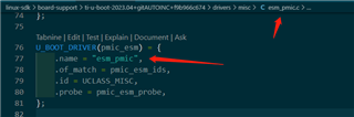

  • Hi Keerthy,
    This is a supplement.
    I found that the name of "pmic_esm" driver is esm_pmic.
    Regrads,
    Maxiel

    Another issue, our hardware engineers said that they disabled the Watchdog of PMIC on the hardware. They set the gpio-8 and gpio-9 of the TPS6594X with external pull-up.
    However, I can still successfully run the Watchdog test demo, which means that their hardware design will not affect the Watchdog.
    Please help to confirm whether the result I got now makes sense.
    Regrads,
    Maxiel
  • Maxiel,
    That's great. The tests SoC watchdog and not the pmic watchdog.
    So what you are observing must be reset from SoC watchdog.
    Closing this issue.
