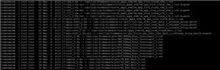

I am working with the TI TDA4VM J721E architecture and would like to load R5F and C7x DSP binary firmware and tried to test the default example program for all available cores (R5F, and C7x DSP) through IPC mechanism.
We are referenced below link for symbolic link the binary firmware.
https://software-dl.ti.com/jacinto7/esd/processor-sdk-linux-jacinto7/10_00_00_08/exports/docs/linux/Foundational_Components_IPC_J721E.html
Please help the below queries:
  • We tried to execute the default examples (rpmsg_char_simple &rpmsg_client_sample). we are not getting the excepted output as mentioned in the TI website.
  • We are getting output for remote proc (rproc_id :R5F_MCU0_0) and for remaining cores, we are not getting the output.
  • I have attached the screenshot and log.

    Can you please check if the softlinked binary is ipc_echo_testb or vision_apps binary?
    By default we have the vision_apps binary and this rpmsg_char_simple does not work in this case.
    You would have to run the vision_apps example ./vx_app_arm_ipc.out to check the communication from A72 to other cores.
    The MCU1_0 works as it is disabled in vision_apps by default.

    we are tried checking the default softlink link binary files. The corresponding sample program ( ./vx_app_arm_ipc.out ) is tested, and it's working.
    APP: Init ... !!!

    I have soft-linked the IPC echo test binary to all cores as mentioned in the TI website.
    ls -al /lib/firmware
    lrwxrwxrwx  1 root root   76 Nov  6 04:18 j7-c66_0-fw-sec -> /lib/firmware/ti-ipc/j721e/ipc_echo_test_c66xdsp_1_release_strip.xe66.signed
    lrwxrwxrwx  1 root root   69 Nov  6 04:18 j7-c66_1-fw -> /lib/firmware/ti-ipc/j721e/ipc_echo_test_c66xdsp_2_release_strip.xe66
    lrwxrwxrwx  1 root root   76 Nov  6 04:18 j7-c66_1-fw-sec -> /lib/firmware/ti-ipc/j721e/ipc_echo_test_c66xdsp_2_release_strip.xe66.signed
    lrwxrwxrwx  1 root root   65 Nov  6 04:18 j7-c71_0-fw -> /lib/firmware/ti-ipc/j721e/ipc_echo_test_c7x_1_release_strip.xe71
    lrwxrwxrwx  1 root root   72 Nov  6 04:18 j7-c71_0-fw-sec -> /lib/firmware/ti-ipc/j721e/ipc_echo_test_c7x_1_release_strip.xe71.signed
    lrwxrwxrwx  1 root root   65 Nov  6 04:18 j7-main-r5f0_0-fw -> /lib/firmware/ti-eth/j721e/app_remoteswitchcfg_server_strip.xer5f
    lrwxrwxrwx  1 root root   72 Nov  6 04:18 j7-main-r5f0_0-fw-sec -> /lib/firmware/ti-eth/j721e/app_remoteswitchcfg_server_strip.xer5f.signed
    lrwxrwxrwx  1 root root   67 Nov  6 04:18 j7-main-r5f0_1-fw -> /lib/firmware/ti-ipc/j721e/ipc_echo_test_mcu2_1_release_strip.xer5f
    lrwxrwxrwx  1 root root   74 Nov  6 04:18 j7-main-r5f0_1-fw-sec -> /lib/firmware/ti-ipc/j721e/ipc_echo_test_mcu2_1_release_strip.xer5f.signed
    lrwxrwxrwx  1 root root   67 Nov  6 04:18 j7-main-r5f1_0-fw -> /lib/firmware/ti-ipc/j721e/ipc_echo_test_mcu3_0_release_strip.xer5f
    lrwxrwxrwx  1 root root   74 Nov  6 04:18 j7-main-r5f1_0-fw-sec -> /lib/firmware/ti-ipc/j721e/ipc_echo_test_mcu3_0_release_strip.xer5f.signed
    lrwxrwxrwx  1 root root   67 Nov  6 04:18 j7-main-r5f1_1-fw -> /lib/firmware/ti-ipc/j721e/ipc_echo_test_mcu3_1_release_strip.xer5f
    lrwxrwxrwx  1 root root   74 Nov  6 04:18 j7-main-r5f1_1-fw-sec -> /lib/firmware/ti-ipc/j721e/ipc_echo_test_mcu3_1_release_strip.xer5f.signed
    lrwxrwxrwx  1 root root   68 Nov  6 04:18 j7-mcu-r5f0_0-fw -> /lib/firmware/ti-ipc/j721e/ipc_echo_testb_mcu1_0_release_strip.xer5f
    lrwxrwxrwx  1 root root   67 Nov  6 04:18 j7-mcu-r5f0_1-fw -> /lib/firmware/ti-ipc/j721e/ipc_echo_test_mcu1_1_release_strip.xer5f
    lrwxrwxrwx  1 root root   78 Mar  9  2018 j7-mcu-r5f0_1-fw-sec -> /usr/lib/firmware/ti-ipc/j721e/ipc_echo_test_mcu1_1_release_strip.xer5f.signed
    lrwxrwxrwx  1 root root   53 Mar  9  2018 j7-pru0_0-fw -> /usr/lib/firmware/pru/PRU_RPMsg_Echo_Interrupt0_0.out
    lrwxrwxrwx  1 root root   53 Mar  9  2018 j7-pru0_1-fw -> /usr/lib/firmware/pru/PRU_RPMsg_Echo_Interrupt0_1.out
    lrwxrwxrwx  1 root root   53 Mar  9  2018 j7-pru1_0-fw -> /usr/lib/firmware/pru/PRU_RPMsg_Echo_Interrupt1_0.out
    lrwxrwxrwx  1 root root   53 Mar  9  2018 j7-pru1_1-fw -> /usr/lib/firmware/pru/PRU_RPMsg_Echo_Interrupt1_1.out
    lrwxrwxrwx  1 root root   53 Mar  9  2018 j7-rtu0_0-fw -> /usr/lib/firmware/pru/RTU_RPMsg_Echo_Interrupt0_0.out
    lrwxrwxrwx  1 root root   53 Mar  9  2018 j7-rtu0_1-fw -> /usr/lib/firmware/pru/RTU_RPMsg_Echo_Interrupt0_1.out
    lrwxrwxrwx  1 root root   53 Mar  9  2018 j7-rtu1_0-fw -> /usr/lib/firmware/pru/RTU_RPMsg_Echo_Interrupt1_0.out
    lrwxrwxrwx  1 root root   53 Mar  9  2018 j7-rtu1_1-fw -> /usr/lib/firmware/pru/RTU_RPMsg_Echo_Interrupt1_1.out
    lrwxrwxrwx  1 root root   39 Mar  9  2018 j7-txpru0_0-fw -> /usr/lib/firmware/pru/TX_PRU_Halt_0.out
    lrwxrwxrwx  1 root root   39 Mar  9  2018 j7-txpru0_1-fw -> /usr/lib/firmware/pru/TX_PRU_Halt_1.out
    lrwxrwxrwx  1 root root   39 Mar  9  2018 j7-txpru1_0-fw -> /usr/lib/firmware/pru/TX_PRU_Halt_0.out
    lrwxrwxrwx  1 root root   39 Mar  9  2018 j7-txpru1_1-fw -> /usr/lib/firmware/pru/TX_PRU_Halt_1.out
