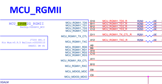

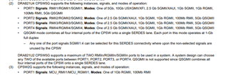

I only see on Gigabit Ethernet port  on DRA821U4
Even on the reference design files for DRA821U4
PROC105E8A(001)_SCH.pdf
PROC084E3A(001)_SCH.pdf
I do not see a second gigabit Ethernet port!
Please show me how to add the second Gigabit Ethernet port to my design using DRA821U4
