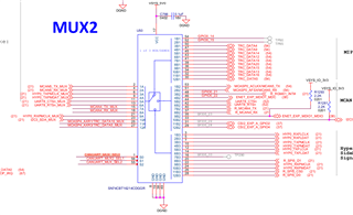

    MCAN5 is a muxed output. Following taken from the schematic file that can be downloaded from "Design files" section on the EVM product page: https://www.ti.com/tool/J784S4XEVM
    The mux in use is this mux: https://www.ti.com/lit/ds/symlink/sn74cbt16214c.pdf

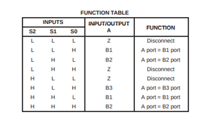

    You will need to turn off/on the S0/S1/S2 signals in device tree so that the B2 lines are outputted:

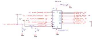

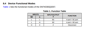

    Additionally, MCAN5 has an additional mux between MCASP and MCAN5:
    So, this documentation for the mux will need to be referenced: https://www.ti.com/lit/ds/symlink/sn74cb3q3257.pdf
    Specifically, B2 will need to be selected.

    My current suspicion for not seeing the MCAN output is still the muxing, but the second portion of muxing. To quote my previous response:
    By default, I see a DNI (Do Not Install) for the pull up resistor in EVM schematics and the line is instead pulled down, so default should select B1. We will want B2 to be selected for MCAN5 output, so outputting high the AUDIO_MUX_SEL on exp1 looks to be the missing piece.
