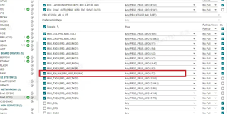

Customer is working on AM64x SDK9.2.
Customer just bring up their own development board successfully. And they have tested their CPSW ethernet ports are also working normally.
However, as customer is using ICSSG0 instead of the default ICSSG1 on EVM, they followed the below thread for the corresponding SW modifications.
https://e2e.ti.com/support/processors-group/processors/f/processors-forum/1230894/am6442-ti-am6442-icssg0-ethernet-ports-doesn-t-work
The difference is the address of main_pktdma discussed in the above thread. The corresponding pinmux configuration is provided below, please help to review.
       mii0_pins_default: mii0-default-pins {
              bootph-all;
              pinctrl-single,pins = <
                     AM64X_IOPAD(0x0184, PIN_INPUT, 1) /* (W6) PRG0_PRU0_GPI9.MII0_COL */
                     AM64X_IOPAD(0x0188, PIN_INPUT, 1) /* (AA5) PRG0_PRU0_GPI10.MII0_CRS */
                     AM64X_IOPAD(0x0160, PIN_INPUT, 1) /* (Y1) PRG0_PRU0_GPI0.MII0_RXD0 */
                     AM64X_IOPAD(0x0164, PIN_INPUT, 1) /* (R4) PRG0_PRU0_GPI1.MII0_RXD1 */
                     AM64X_IOPAD(0x0168, PIN_INPUT, 1) /* (U2) PRG0_PRU0_GPI2.MII0_RXD2 */
                     AM64X_IOPAD(0x016c, PIN_INPUT, 1) /* (V2) PRG0_PRU0_GPI3.MII0_RXD3 */
                     AM64X_IOPAD(0x0170, PIN_INPUT, 1) /* (AA2) PRG0_PRU0_GPI4.MII0_RXDV */
                     AM64X_IOPAD(0x0174, PIN_INPUT, 1) /* (R3) PRG0_PRU0_GPI5.MII0_RXER */
                     AM64X_IOPAD(0x018c, PIN_OUTPUT, 0) /* (Y3) PRG0_PRU0_GPO11.MII0_TXD0 */
                     AM64X_IOPAD(0x0190, PIN_OUTPUT, 0) /* (AA3) PRG0_PRU0_GPO12.MII0_TXD1 */
                     AM64X_IOPAD(0x0194, PIN_OUTPUT, 0) /* (R6) PRG0_PRU0_GPO13.MII0_TXD2 */
                     AM64X_IOPAD(0x0198, PIN_OUTPUT, 0) /* (V4) PRG0_PRU0_GPO14.MII0_TXD3 */
                     AM64X_IOPAD(0x019c, PIN_OUTPUT, 0) /* (T5) PRG0_PRU0_GPO15.MII0_TXEN */
                     AM64X_IOPAD(0x0178, PIN_INPUT, 1) /* (T3) PRG0_PRU0_GPI6.MII0_MR0_CLK */
                     AM64X_IOPAD(0x01a0, PIN_INPUT, 1) /* (U4) PRG0_PRU0_GPI16.MII0_MT0_CLK */
                     AM64X_IOPAD(0x01a4, PIN_INPUT, 7) /* (U1) PRG0_PRU0_GPO17.GPIO1_17 INTn */
                     AM64X_IOPAD(0x01a8, PIN_INPUT, 7) /* (V1) PRG0_PRU0_GPO18.GPIO1_17 nRST */
                     //AM64X_IOPAD(0x01ac, PIN_OUTPUT, 2) /* (W1) PRG0_PRU0_GPO19.PRG0_IEP0_EDC_SYNC_OUT0 */
Customer used MII interface in ICSSG0 connecting to the DP83826, the corresponding dts is provided below.
https://e2e.ti.com/cfs-file/__key/communityserver-discussions-components-files/791/0451.k3_2D00_am642_2D00_evm.dts
After all these setup, customer found that the ping will fail in ICSSG0 and causing the kernel crash. After customer debug using the ethtool & ifconfig, they found that there is package loss.
Please see the below log for details.

  • Hi Nick,
    Customer has read the register, and confirms that it is already in MII mode.
    Please share us some clue to debug further, many thanks!
    Kevin

  • Hi Nick,
    We checked customer's schematic also, there is one more point may need to confirm with you. As we discussed customer is using ICSSG0 MII, but they did not connect the MII0_RXLINK which is at PRG0_PRU0_GPO8 pin shown below. Customer wants to know if there will be any potential functionality effects for not connecting this pin but still using the PRU ICSSG0 MII.
    Many Thanks,
    Kevin
  • Hi Nick,
    Customer has fixed the problem.
    In short, our ICSSG firmware requires to configure both of the two ethernet ports to make it work normally. However, in customer board they only use 1 ethernet, and also only 1 phy connecting to it. By default in the SW, when we enable & configure two ethernet ports in the icssg firmware it will timeout & crash when it does not detect the second PHY. Customer made a workaround, they still configured two ethernet ports, but only link the one which they used (the one has the PHY), by doing so, the firmware could be used now, and there is no more crash problem occurred.
    Kevin
