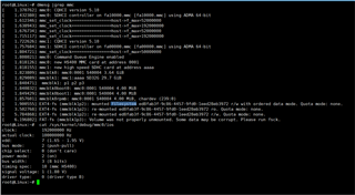

  • Hi Prashant,
        According to your suggestion, I have added corresponding modifications in the kernel, using oscilloscope measurements, still at 200MHz.
    --- a/arch/arm64/boot/dts/ti/k3-am62p-main.dtsi
    +++ b/arch/arm64/boot/dts/ti/k3-am62p-main.dtsi
    @@ -611,6 +611,7 @@
                    clock-names = "clk_ahb", "clk_xin";
                    assigned-clocks = <&k3_clks 57 2>;
                    assigned-clock-parents = <&k3_clks 57 4>;
    +               max-frequency =<192000000>;
                    bus-width = <8>;
                    mmc-ddr-1_8v;
                    mmc-hs200-1_8v;
    Can you please share the output of the following commands:
    => dmesg | grep mmc
    => cat /sys/kernel/debug/mmc0/ios
    Thanks!
  • Hi Prashant,
        The relevant information is as follows:
  • Hi Prashant,

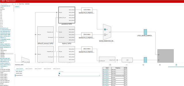

  • Hi Prashant:
    Because we do not support 192M.
    Use sysconfig we found that we can set eMMC clock to 125MHz. work with customer use two method setting it. But use oscilloscope test the clock just run at 100MHz.
    Could you please verify it at your side?
    Thanks!
    Method 1: use below modify at EVM board.
                 #K3conf dump clock
                    found PLL0 DIV5 do not changed and emmc clock still is 125MHz
    @@ -611,7 +611,10 @@ sdhci0: mmc@fa10000 {
    -               bus-width = <8>;
    +               clock-frequency = <125000000>;
    +              max-frequency =<125000000>;
    Method2:
    #devmem2 0x00680094 w 0x8007
    directly change clock tree setting, but use oscilloscope test it eMMC clock change to 100Mhz, do not setting to we wanted 125MHz
