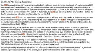

    I do not have any reference materials I can give for setting up ATU properly. However, I do see something that may be an issue. By default dw_pcie_prog_inbound_atu is using BAR matching mode. This is not the recommended for RC.
    TRM would be the best place to look at how PCIe should be configured and according to the TRM, it looks like address matching mode is the preferred method for RC.

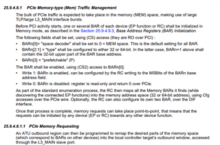

  • Hi Phaneesh,
    Again, TRM will be the best location for information. We do not have company internal information or examples for setting inbound ATU for PCIe on AM57x. I understand that TRM is a large read, but reading through this will give you some points to consider for debug.
    For example, like below info:
    Essentially, PCIe tries to access PCIe address, and in Linux (at least for our newer AM6x/J7x devices) we declare a range for PCIe data in device tree: https://github.com/torvalds/linux/blob/master/arch/arm64/boot/dts/ti/k3-j721e.dtsi#L110
    I assume something similar might be needed for AM57x. Otherwise, section 25.9.x should give you some other pointers to check.
