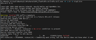

  • Hi Bin,
    Bin Liu said:
        At the U-Boot prompt, perform the following two commands. Alternatively, these two u-boot commands may also be built into u-    boot.
    Falcon boot skipped A53 Uboot, can't the Uboot command be used?
    I changed the name of atf-tee-dm-kernel-fdt.bin to tispl.bin, and also changed the k3_dfu. h file as you suggested. I was able to successfully transfer the tiboot3.bin file to the development board, but when I tried to transfer the tispl.bin file, it froze at 8%. Our EMMC boot partition size is 2M, and the tispl.bin file size is 20.5M. I feel that tiboot3.bin and tispl.bin have been transferred to the EMMC boot partition.
    The problem I am currently facing is:
    1. Our Falcon boot is implemented based on EMMC UDA boot mode. Now, we have skipped A53 Uboot and cannot use the Uboot command. How can we implement EMMC GPT partitioning?
    2. How can dfu_util place the firmware in the correct EMMC UDA partition location?
