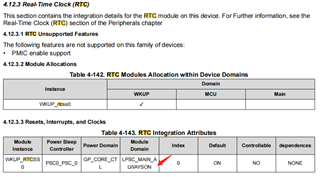

The register in the following image can be used to save data when the system loses power:
We want to use the register in the picture above to implement the function of saving data in case of power failure, but we cannot find the power supply pin of the RTC.
Generally, external RTCs have a power supply pin connected to the button battery. When the system is powered off, the button battery continues to supply power to the external RTC chip.

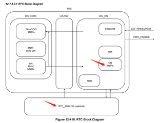

I found the following related pictures in TRM:
My question is, if we want to implement the function of saving data in case of power failure, how can the RTC module inside am62x keep running when the system is powered off?

    I am sending your thread to a member of our hardware team to discuss how to connect battery backup to the AM62x.
    I am not sure connecting the battery to the SOC is a use case that has been considered.
    we have other processor families in road map that could support the functionality.

    We are not currently considering changing the processor, we just want to know if the function of connecting the battery to the SOC has been implemented on the am6234 chip
    This is not implemented or supported.

    The register is part of the IP and does not have an use case for AM625
    If that's the case, won't the data stored in the RTC_STC_SCRTCH0_N register be lost after the system is powered off?
    What is the application scenario of the RTC-STC_SCRTCH0_N register designed by TI?
    This is correct. The data will not be retained when the SOC is powered-off.

    Overall, can I understand that this register cannot be used to implement the function of power down saving?Because the battery cannot be connected to SOC for this register to retain data
    Li
  • What exactly do you mean by 'IO' here?
    This is a typo - this should be IP (peripheral design). I updated the original message.
    So how should we explain this?
    This is correct. The register does not have a use case with AM625.
