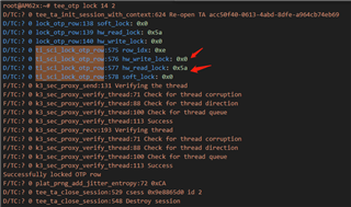

I only want to execute hw_read_lock on extend otp rows, but in actual testing, not only is the row read locked, but the row write is also locked, as shown below:
1.Log of locking external otp row
2.Locking status of external OTP rows:

Li
    This is expected. The TIFS also enables the write lock if the read lock is requested for a row.
    Prashant

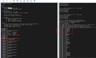

    When I only perform the Hardware write lock operation, the Hardware read lock occurs, as shown in the following figure
    But I perform the same operation in the MCU SDK, only Hardware write lock and Hardware read unlock,I am puzzled as to why such an error occurs in Optee.
    Li
    Have you tried to read the status of the row 3 from the MCU+ SDK?
    This is to see if there is an implementation mistake for getting the status either in optee_os or tee_otp client.
    Prashant
    I used the MCU SDK to read the lock status of row 3, and the result showed a hard read lock:
    From the above results, it can be inferred that when performing a hard read lock under Optee, the hard write also locks. Similarly, when performing a hard write lock, the hard read locks. How can we solve this problem?
    The above phenomenon does not occur in the MCU SDK.
    At the same time, even when the hardware read has been locked, row 3 can still be read using the CA program in Linux. Why is it possible to read row 3 even after the read is locked?
    Li
    This part is unexpected. I will once go through the OPTEE implementation of TISCI_MSG_LOCK_OTP_ROW & get back to you.

    Li
    So, it can be understood that even after the row is locked, both row read and mmr read can read otp normally.
    The TIFS doesn't provide any API for reading the low level rows. The `ext_otp_readMmr` function, though meant for reading the rows, just calculates the required MMR indexes to be read & derive the row value from them. So, the low level rows are never read.
    My question is, after the row is locked, reading otp is not affected in any way. So what is the purpose of this row lock API interface? Under what circumstances will this row lock function be used?
    For Extended OTP, there really isn't any use case for the read lock. Hypothetically, if the TIFS provided an API interface for reading the low level rows, it could then have leveraged the read lock permission bit to control the reading in a certain way.
    Like for Secure OTP, the TIFS leverages the read lock permission bit to determine if the KEYCNT, KEYREV could be read back using the TISCI_MSG_READ_KEYCNT_KEYREV.
