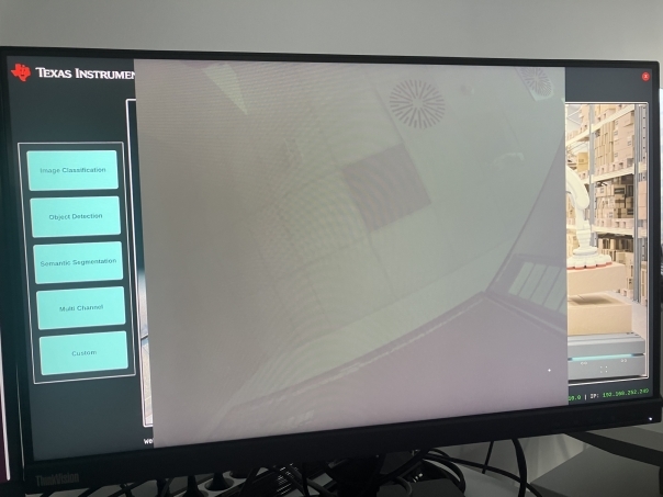

Hello there TI Experts,
I am trying to use the the edgeai_tiovx_apps with my own imx568 Linux camera driver. When I launch the application I get an image like this:
As you can see it shows me something from the reality but its quite distorted. It looks like the byte order or something like that is messed up in the buffers.
In my case if I use v4l2-ctrl the image is perfectly captured. So it seems like the tiovx pipeline messes up something:
$ v4l2-ctl -d /dev/video-imx568-cam0 --set-fmt-video=width=1236,height=1032,pixelformat=RG12 --stream-mmap --stream-skip=10 --stream-count=1 --stream-to=testStream1236.raw
My format in this case is:
IMX568_CAM_FMT="${IMX568_CAM_FMT:-[fmt:SRGGB12_1X12/1236x1032]}"
To make things more interesting: My camera can also operate on 2472x2064 resolution:
IMX568_CAM_FMT="${IMX568_CAM_FMT:-[fmt:SRGGB12_1X12/2472x2064]}"
In this resolution the TIOVX application is working perfectly, just like the v4l2-ctrl. So this problem only occurs with 1236x1032, and only with edgai-apps-stack. The stream is continuous and AEWB seemingly working (stream adapts to the brightness of the room), so I think the problem is not with the DCC files.
Thank you for your help!
Zsombor Szalay
  • Hi Zsombor,
    Are you re-configuring the sensor to the desired format between capture tests? Does this sensor require ISP tuning? Each sensor configuration requires its own set of DCC binaries.
    FAQ: https://e2e.ti.com/support/processors-group/processors/f/processors-forum/1403223/faq-most-common-problems-encountered-when-developing-camera-applications-on-the-am6x
    ISP Tuning Guide: https://www.ti.com/lit/an/sprad86a/sprad86a.pdf

  • Hi Fabiana!
    I have generated DCCs with default_DCC_profile_gen. I haven't done ISP tuning since the default DCC-s worked pretty well with the 2472x2064 resolution (of course I generated different DCC-s for the different resolution - 1236x1032). Can this cropped, fragmented, distorted, mixed up and messed up output be the result of the lack of ISP tuning? The diagonal lines in the middle of the image which separates the mixed up segments made me think that the error has nothing to do with auto white balance and stuff like that (error is not corresponded to DCCs).
  • Hi Zsombor,
    Do you see the same distortion when running edgeai-gst-apps? I recommend running some basic GStreamer test pipelines. See this FAQ to help you build a pipeline for IMX568: https://e2e.ti.com/support/processors-group/processors/f/processors-forum/1427869/faq-sk-am69-how-to-stream-from-csi-sensor-to-display-using-gstreamer

  • Unfortunately  edgeai-gst-apps doesn't even starts. Here is the error what i get when I try use optiflow:

    Optiflow is also working fine with the same camera on 2472x2064 resolution (just like tiovx-apps). Here is the generated gst pipeline on that case:

  • Hi Zsombor,
    Could you try running two test pipelines with the respective dcc binaries? Be sure to change the sensor configuration to match the test pipeline before running the command.

  • Of course imx219 is working with the gst-apps and also with the tiovx-apps (8 bit and 10 bit as well). I have used the imx219 driver as template to create my own driver. As I mentioned before imx568 is also working well with gst-app and tiovx-apps on 2472x2064 resolution. But in 1236x1032 something goes wrong. tiovx-apps gives me that messed up image and gst-apps (like optiflow) doesn't even start.
  • Hi Zsombor,
    Yes, imx219 should work as expected. I was just using the imx219 pipeline as an example, but I can create the imx568 pipelines for you. Follow step 3 of this FAQ to configure the format of the sensor to match the target resolution.
    imx568 (2472 x 2064)

    Try these and let me know if the 1236x1032 resolution is still giving you trouble.

  • The result in the case of imx568 (1236 x 1032) - It doesn't start:
    root@tda4vm-sk:/opt/edgeai-tiovx-apps# v4l2-ctl -d /dev/v4l-imx568-subdev0 --set-ctrl=imx568_frame_rate_control=30
    root@tda4vm-sk:/opt/edgeai-gst-apps/scripts# gst-launch-1.0 v4l2src device=/dev/video-imx568-cam0 io-mode=5 ! queue leaky=2 ! video/x-bayer, width=1236, height=1032, framerate=30/1, format=rggb12 ! tiovxisp sink_0::device=/dev/v4l-subdev0 sensor-name="SENSOR_SONY_IMX568" dcc-isp-file=/opt/imaging/imx568/linear/dcc_viss_1236x1032.bin sink_0::dcc-2a-file=/opt/imaging/imx568/linear/dcc_2a_1236x1032.bin format-msb=11 ! video/x-raw, format=NV12, width=1236, height=1032, framerate=30/1 ! kmssink driver-name=tidss sync=false

    The result in the case of imx568 (2472 x 2064) - Works perfectly:
