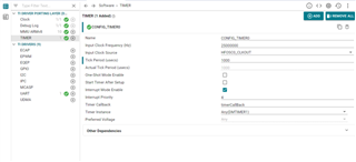

I am trying to develop a timer interrupt for an application using sysconfig as shown below. I set input clock frequency, input clock source, and tick period, and also enable interrupt mode with a timer callback function.
I already declared a timer callback function in the main c file to ensure there is an error when building the project. If I already set the tick period in the sysconfig, should I edit another interrupt function inside the timer callback function? Or please provide me with a simple guide of timer interrupt setup and configuration using sysconfig. Thank you!

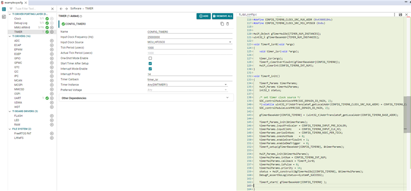

    I already defined it in the main c file. Actually, there is no error as of now. But I am curious on how to build timer interrupt for the project. Is timerCallBack function a timer isr function where we define the timer interrupt, for an example, it occurs every 100us? Or is there an example on this timer isr where I can follow?
  • Hello Sopheap,
    Yes, the timerCallBack is an timer ISR function. Sysconfig will generate the appropriate code for setting the timer ISR as configured.
    Please refer below image where a timer_isr is configured to occur every 1000 us.
    Hope the above information helps.
