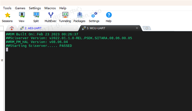

  • I test by example,it also not working
    it enter a loop,please refer the following picture
  • It looks like the execution didn't even reach the main function of the example. May I know how are you actually running or booting the example?

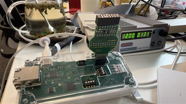

  • I bootstrap up with SBL and load it through CCS, and I use the same method when debugging other examples.
    In addition, the problem I described in SBL seems to have a problem without running to the main function, because after the initialization of the main function is completed, the information is output through the serial port, but after downloading the image of the operation of the MMCSD_write function, any serial port information is not output

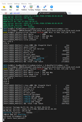

    This is incorrect method. The WKUP R5F examples cannot be run using CCS. They must be booted by SBL as described here:
    AM62Ax MCU+ SDK: Developing applications on Device Manager/Wake-up R5 core
  • I use this method test the example which it test passed.
    For my issue,have any analytical methods?

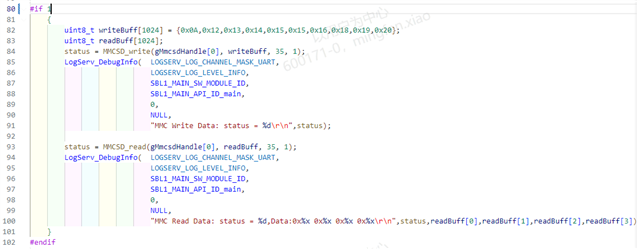

  • I refer the link of https://software-dl.ti.com/mcu-plus-sdk/esd/AM62AX/10_00_00_14/exports/docs/api_guide_am62ax/DEVELOP_AND_DEBUG_DMR5.html to debug my code. When a Added flowing code use the CCS debug,is operation sucessed.
            uint8_t writeBuff[1024] = {0x11,0x12,0x13,0x14,0x15,0x15,0x16,0x18,0x19,0x20};
            uint8_t readBuff[1024];
            status = MMCSD_write(gMmcsdHandle[0], writeBuff, 35, 1);
            LogServ_DebugInfo(  LOGSERV_LOG_CHANNEL_MASK_UART,
                                LOGSERV_LOG_LEVEL_INFO,
                                SBL1_MAIN_SW_MODULE_ID,
                                SBL1_MAIN_API_ID_main,
                                0,
                                NULL,
                                "MMC Write Data: status = %d\r\n",status);
            status = MMCSD_read(gMmcsdHandle[0], readBuff, 35, 1);
                                0,
                                NULL,
                                "MMC Read Data: status = %d,Data:0x%x 0x%x 0x%x 0x%x\r\n",status,readBuff[0],readBuff[1],readBuff[2],readBuff[3]);
    but i use same code,flash the image to chip,it will crash.
    the flash method:
    - use the USB DFU flash the dm-am62ax-sbl_emmc_stage1.release.hs_fs.tiimage file
    when i deleted above code and use the same method flash the image,it not crash
    Do you have any ideas for this issue?
