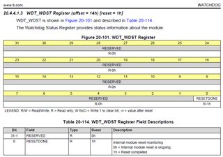

    AM335x does have the WDT_WDST (Watchdog Status Register). From the AM335x Technical Reference Manual (TRM):
    But I have not played around with AM335x registers at this point. My assumption is that this register would stay at 0x0 if it attempted a reset of the processor and the processor did not actually reset, but I cannot say for sure.
    You can use the devmem2 tool to read register values from the Linux terminal.

    And for the watchdog register, I also found this one below, we could know the warm reset is coming from Watchdog or SW by reading this register 0x44E00F08.
