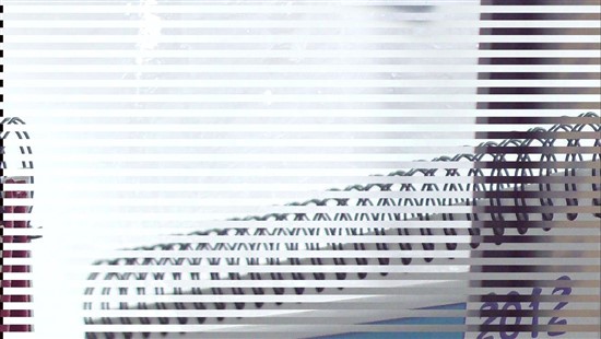

  • xiaofeng xu68950 said:
    hi,gomo,
    I have done you say above, the client the live555 transplantation to the MPlayer, live555 the following changes:
       JPEGVideoRTPSource.cpp
      unsigned width = (unsigned)headerStart[6] * 16;
      unsigned height = (unsigned)headerStart[7] * 16;
     but the image is still not normal, my resolution is 2592 * 1920
    can you give me more information?
    thanks a lot!!
    Look the image, the resolution is still not correct.
    You must check again. And you can save snap image from the Live555 directly, and use tool(WinHex) to modify the Jpeg resolution( w and H) by manual and the see the image whether is ok.
  • Glad to receive your reply,
    In accordance with what you said, Now, Images can already be displayed properly, but I found the images show only the source data (2592 * 1920)half of the image (1296 *960),
    I do not know how to modify.
    can you give me some help?Thanks again
  • 1)Save a pic
     2)google to find the JPEG format,
     3)use a tool (such ad WinHex) to go to the width and height,
     4)modify the value to  2592  1920, and save as
     5)use the image tool to open.
     6)See the picture whether is correct.  If the image is correct, It prove the resolution of parse  is wrong in the client.
