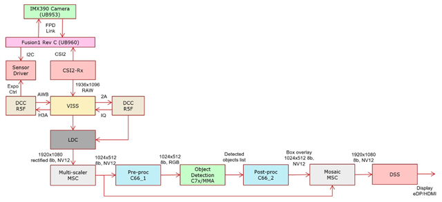

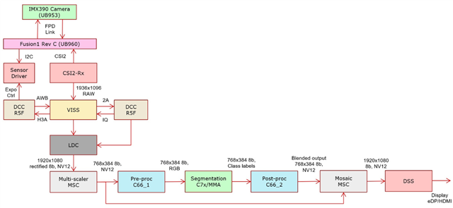

Hello TI experts,
I'd like to know if it is possible to run 2 DL networks at the same time with one camera input source, which would be somehow merged structure with below diagrams,
Juhyun
Hello TI experts,
Juhyun
Yes we can. We do not have a camera based input example, but you can refer the file based demo below and integrate camera pipeline to this.
Vision Apps User Guide: Auto Valet Parking Application
Nikhil
