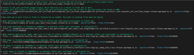

I am using uart_uniflash.py file for flashing the u-boot images to OSPI Nand flash and these are my configuration file as show below.
and I'm downloaded, using ~/ti/ti-processor-sdk-linux-am62xx-evm-10.00.07.04/bin/uart_uniflash/bin files for flashing.
But successful flash to Nand. I have changed the boot mode pins to xSPI boot.
But Its not booting form Nand.
Could you please help me on this.

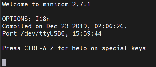

    I understand that upon changing it to xSPI bootmode it is not booting and you are not able to see any logs on the COM PORT either.

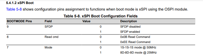

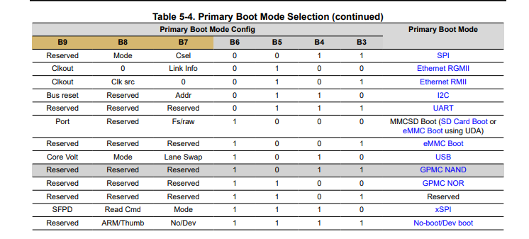

    What I want you to do as of now is:
    1. Firstly check if the xSPI bootmode you selected is correct or not? Does it match the following table?
      Please also tell me the values of the following fields:
