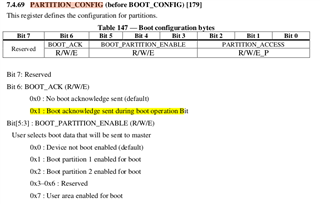

  • Hi terry,
    The reason could be that the PARTITION_CONFIG byte of the EXT_CSD register would have been set to boot1 configuration .The PARTITION_CONFIG byte of the EXT_CSD register is responsible for deciding which partition of the eMMC to boot from.
    In the above image,boot partition 1 refers to boot 0 and boot partition 2 refers to boot 1.
