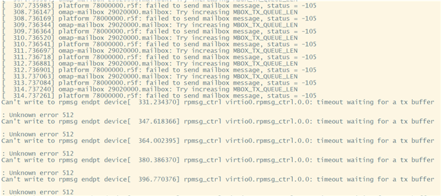

I did some test about the RPMsg from A53 Linux to R5 FreeRTOS. I used rpmsg_char_simple on Linux side and empty project with transport RPMsg codes on R5 FreeRTOS side.
I changed rpmsg_char_simple to continuously send rpmsg(with length 8bytes) every 1s, and project on R5 side just do RPMessage_recv() forever. Several tens of seconds later, R5 side will enter data abort exception.
Bellow is the console outputs of Linux side:

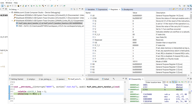

How to detect whether there was a memory leak in RPMSG usage of R5 side? Is there any tools that can check the memory leak of R5 FreeRTOS?
Best Regards
xixiguo
  • Hi Xixiguo,
    Thanks for your query.
    Generally the data abort exception comes when you try to access memory which is invalid or doesn't have required permission to read/write.
    Can you please check in the code are you using such memory location? Or can you please share the code with us?

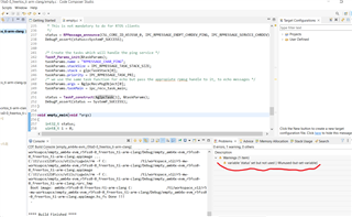

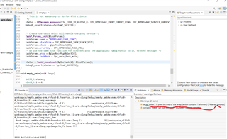

  • Hi Tushar,
    Bellow is my empty.c and main.c that used to receive the RPMsg,

  • Hi Tushar,
    I think I found why this issue occured.
    I used CCS12.1.0 and TI Clang v3.2.2.LTS
    I found that there was an error in my empty.c code, but the compiler or CCS didn't show it in Description after Rebuild.
    #define IPC_RPMESSAGE_NUM_RECV_TASKS         (1u)
    TaskP_Object gIpcTask[IPC_RPMESSAGE_NUM_RECV_TASKS];
    status = TaskP_construct(&gIpcTask[1], &taskParams);
    Here status = TaskP_construct(&gIpcTask[1], &taskParams); is wrong, it should be status = TaskP_construct(&gIpcTask[0], &taskParams);
    But after Rebuild, I could not see it in the Description,
    If I used status = TaskP_construct(&gIpcTask[2], &taskParams);  I could see the warning in the Description,
    Best Regards
    xixiguo

  • xixigo,
    Can you provide all the output in the build console for both the case where the message does not appear and when it appears? You can copy and past the output to a text file and attach it to this thread
    ki
  • Hi ki,
    Both output of the build console,

  • Here status = TaskP_construct(&gIpcTask[1], &taskParams); is wrong, it should be status = TaskP_construct(&gIpcTask[0], &taskParams);
    While I cannot be certain, I am confident that glpcTask[1] and glpcTask[0] are both valid expressions.  That being the case, the compiler is unable to help you find this particular error.
    Thanks and regards,
    -George
  • Hi George,
    Thanks, but I can not understand that when the glpcTask array has only one element defined like below,
    Should glpcTask[1] be invalid expression?
    Best Regards
    xixiguo
  • Should glpcTask[1] be invalid expression?
    No.
    But the compiler is not required to issue a diagnostic in such a case.  In simpler cases, the tiarmclang compiler issues a diagnostic.  But not in your case.  I don't know why.  I hesitate to ask for a test case.  Because, while I'm not sure, I suspect that once we understand why you don't see a diagnostic, it will turn out that changing the compiler to detect your case is very difficult.  I want to avoid the impression an easy fix is available.
    Thanks and regards,
    -George
  • ok, if there's any update about this, please let me know.
    BR
    xixiguo
  • I didn't think I left the impression that TI planned to do anything further.  While a complete investigation has not occurred, I'm very confident there is little we can do to help this particular case.  Do you think this should be investigated further?
    Thanks and regards,
    -George
  • Hi George,
    I think it should be investigated further. If it should not be compiler to issue a diagnostic in such a case, please route it to the teams you think it belongs to.
    Or should I create an other question on any where else?
    BR
    xixiguo
  • For the source file with the invalid reference gIpcTask[1], and no diagnostic is issued when it is built, please follow the directions in the article How to Submit a Compiler Test Case.
    Thanks and regards,
    -George
  • Ok, thanks.
