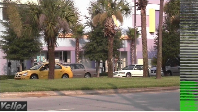

I am test the commponet OMX.TI.VPSSM3.VFPC.INDTXSCWB.
My test input video is 1408 * 720 and the right edge has 128 pixels random data, looks as:
I want to test if the component can process the stride, the output image is 640 x 360.
If I set
    inPortDef.format.video.nFrameWidth
        = 1408;
    inPortDef.format.video.nFrameHeight
        = 720;
    inPortDef.format.video.nStride
        = 1408;
    chResolution.Frm0Width = 1408;
    chResolution.Frm0Height = 720;
    chResolution.Frm0Pitch = 1408;
    chResolution.Frm1Width = 0;
    chResolution.Frm1Height = 0;
    chResolution.Frm1Pitch = 0;
    chResolution.FrmStartX = 0;
    chResolution.FrmStartY = 0;
    chResolution.FrmCropWidth = 0;
    chResolution.FrmCropHeight = 0;
    chResolution.eDir = OMX_DirInput;
    chResolution.nChId = 0;

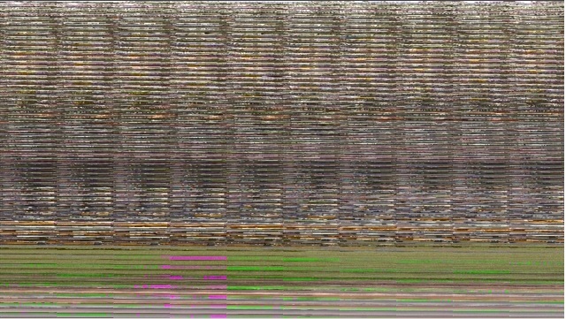

the scale works well, but if I set
= 1280;
= 720;
= 1408;
 chResolution.Frm0Width = 1280;
The scaled picture looked as:
 I believe the component can support stride does not equal width, but I can not know why the result is not right.

  • Gang,
    Sc does work for different pitch and width. In fact if you check the decode_display demo in EZSDK, Scalar pitch is larger than width, as decoder o/p buffer contains padding .
    For other issue, is this allocate buffer is for Decoder or for Scalar. You could also see media controller logs
