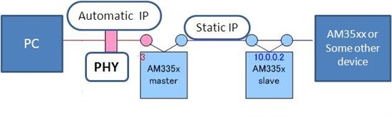

AM335x Ethernet ports
The AM335x device has 3-port switch (3PSW) Ethernet subsystem,
i.e. two Ethernet ports,
is it possible to use AM335x's ethernet as a gateway?
i.e can we connect two different networks as shown below.
Please let us know if this kind of usage is possible.
Regards.
  • I believe this is what is described as Dual Mac Mode in Section 14.3.1.5.2 in the AM335x Technical Reference Manual.
  • Thank you Brandon.
    I understood that there are two independent MAC's( two diff IP address)
    but the manual mentions that there is "no bridging between MAC’s"
    Below is the description written in the Manual 14.3.1.5.2 Dual Mac Mode.
    "When operating in dual mac mode the intention is to transfer packets between ports 0 and 1 and ports 0
    and 2, but not between ports 1 and 2. Each CPGMAC_SL appears as a single MAC with no bridging
    between MAC’s"
    Regards.
  • Correct, there is no bridging performed in hardware.
    Software running on the Cortex-A8 could perform this bridging.  This is what you would likely do in a gateway application anyway, or did I miss the point?
