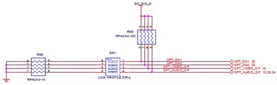

What is difference between vs daughter card version B and C?
Other Parts Discussed in Thread: TVP5158
I am working on dm816x evm board + vs daughter card.
This is fine to run RDK 01.05.00.08 demo code.
Recently, I got an new vs daughter card hw version is C.
After demo code running, I only can see the upper eight channels of analog capture in.
Who can tell me what is the difference between vs daughter card version B and C?
Thanks!
Jacson
    The only difference between Rev B and Rev C is that a CIF interface is brought out via an extra mux in Rev C.
    Marc
  • Hi Marc,
    Why can't I see the other 8 channel analog preview windows when I execute demo code with Rev C?
    Should I need to modify something? I can work fine with Rev B.
    Thanks!
  • I'm not sure.  Can you please provide more details on the procedure you followed?
    Marc
  • Hi Marc,
    I post my log here. At the capture statistic, Only upper 8 channel got fields.
    Is there any suspect point around here?
    Thanks!
    Jacson

    Can you try flipping the OPT_VIDEO_CIF switch?
    Marc
  • Hi Marc,
    Thanks for your answer!
    I can see all video capture image after flipping this switch.
    Jacson
