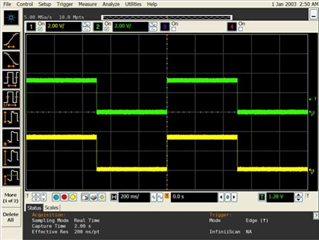

I'm trying to get an PPS output synchronized with PTP.
I will detail how I get my PPS signal:
I use a National Instrument platform that works as a PTP grandmaster. I can get the PPS signal from the NI board.
By ajusting the dtb file, I can get a PPS signal on SYNC1_OUT (header J12 of the EVM board).
/usr/kernel-selftest/ptp/testptp -d /dev/ptp0 -P 1
The green signal is my PPS signal from NI board; the yellow signal is SYNC1_OUT.
After synchronizing the EVM with PTP from NI:
ptp4l -i eth0 -s -q -f /home/ptp.cfg -m > /home/ptp4l.log &
phc2sys -s eth0 -w -q -f /home/ptp.cfg -m > /home/phc2sys.log &
By disabling pps signal and re-enabling it, I get a PPS signal that seems synhcronized with NI PPS signal:
/usr/kernel-selftest/ptp/testptp -d /dev/ptp0 -P 0
Synchronizing PTP seems to synchronize PPS signal but the yellow signal (SYNC1_OUT) has an offset of 30µs:
I guess this offset could be corrected by that command:
/usr/kernel-selftest/ptp/testptp -d /dev/ptp0 -n -30000
Even if I am able to correct it, this offset was not expected. Am I doing something wrong?
Also, the jitter of the PPS signal from SYNC1_OUT is around 1,3µs which seems high to me:
How can I reduce this jitter?
    I am trying to see if I can observe the same result. Are you triggering the rising edge of the PPS signal?
    I trigger on the rising edge of my grandmaster PPS signal.

    Can you explain how the grandmaster clock is setup on the NI device? You mentioned also using the gPTP.cfg file as well on the NI device.
    Also, since the previous command provided did not seem to work for you can try the below instead? The difference is to use software timestamping instead of hardware timestamping.
    ptp4l -P -2 -S -i eth0 -f gPTP.cfg --step_threshold=1 -m -q -p /dev/ptp0 > /dev/null &
    -Daolin
  • Hi Daolin,
    Just to be clear, your test topology is the below?
    NI Device (grandmaster clock) <--ethernet cable--> (eth0) 1x TMDS64EVM
    Yes, that's right.
    Thanks to your inputs, I managed to use the command and synchronize the TMDS64EVM as a follower clock. Some configurations of the grandmaster were not the same as those of the TMDS64EVM.
    However, the PPS signal generated on SYNC1_OUT is not synchronize with the PPS signal from my grandmaster.
    I expected this signal to be synchronize since it is generated from PTP. Am I wrong?
    Also, this signal has a jitter of about 1µs, which seems high to me for my purposes. I wanted to use this signal (PPS) to synchronize time every second on another platform from the clock follower.
    GrandMaster clock <-ethernet-> Clock follower (TMDS64EVM )  <-PPS signal-> Platform that can't manage PTP
    When I boot the TMDS64EVM I got this message:
    [FAILED] Failed to start Synchronize System and HW clocks.
    Should I be concerned? Is it a configuration fault in the dts file?
    Julien
  • Hi Julien,
    Glad that you were able to synchronize the TMDS64EVM as a follower clock.
    You're not wrong, as long as the ptp4l program is running before the testptp program runs, the PPS signal should be synchronized since it's source from the ptp clock.
    This message is unexpected, can you share your entire TMDS64EVM boot log that includes this message? Have you also enabled any start up programs that are running upon boot up (e.g. systemd or initd services) that aren't from the default SDK 10_00_07_04 Linux Image?
