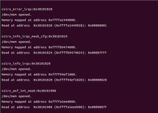

  • HI experts
    I referred to the logic of the camera and set the general settings register, but I still haven't seen the data output. I don't know if the values of these registers are set correctly. Can you help me confirm?
    devices:
    clk:400M
    data format:RAW8
    lane num:4
    registers:

    -----csi2 check info----------\n
    csirx_monitor_irqs_mask_cfg:0x30101110
    /dev/mem opened.
    Memory mapped at address 0xffff984fc000.
    Read at address  0x30101018 (0xffff984fc018): 0x00000000
    /dev/mem opened.
    Memory mapped at address 0xffffb90cb000.
    Read at address  0x3010101C (0xffffb90cb01c): 0x000000FF
    csirx_info_irqs:0x30101020
    /dev/mem opened.
    Memory mapped at address 0xffff9b6ab000.
    Read at address  0x30101020 (0xffff9b6ab020): 0x00000000
    csirx_info_irqs_mask_cfg:0x30101024
    /dev/mem opened.
    Memory mapped at address 0xffffae9ac000.
    Read at address  0x30101024 (0xffffae9ac024): 0x00007FFF
    csirx_error_irqs:0x30101028
    /dev/mem opened.
    Memory mapped at address 0xffff92ca2000.
    Read at address  0x30101028 (0xffff92ca2028): 0x00000100  or  0x00001401
    csirx_error_irqs_mask_cfg:0x3010102c
    /dev/mem opened.
    Memory mapped at address 0xffffb6100000.
    Read at address  0x3010102C (0xffffb610002c): 0x00011FF1

  • First of all, are you using Linux driver or RTOS driver for CSIRX? Are you following application note on adding a new image sensor in the imaging layer? It seems your output format is RAW8, are you also tagging this data with the correct CSI/MIPI format?
    Brijesh
  • Hi expert
    I am using Linux driver(cdns_csi2rx && j721-csi2rx) for CSIRX.i have added device trees and driver modifications as required. The CSI/MiPI tag data format is 0x2a (RAW).
    one chip has 16400 bytes, and a frame has 128 chips. Is it possible that this frame data is too large to be collected?
    How do I configure the registers of dhpy/csi-rx_if/csi2rx_sthim for this situation?
    thanks!
  • hi,
    I am sorry, but i am not familiar with the Linux driver. As such, CSIRX can capture this data, 16400 x 128 frames, but not sure how to configure it on Linux driver. Is it possible for you to use RTOS driver?
    Brijesh
  • Hi
    I used this example(${SDK_PATH}/examples/drivers/csirx/csirx_capture_testapp.) to test RTOS , but no frame captured.
    Does the example's deserializer need to be modified if the development board is directly connected to the camera and how to modify it
    SDK_VER:10.0.00
    thanks
    Yes, you need to update the SERDES and sensor configuration in the SetSensorConfig APi. This is where this example configures SERDES and sensor..
    Brijesh
  • Thank you for your reply. I can already receive the data, but the data length obtained by DMA is 768 bytes. My frame is 16384 * 128 bytes. Do you know how to modify those parameters
  • ok, that means you need to set the width as 16384 and height as 128 and keep the frame format as RAW8.
    Brijesh
  • HI.
    Do you know how to set up DMA/PSILSS as the width as 16384 and height as 128。I'm not using the V4L2 framework and don't know where to set it up。
    thanks!
    This should be taken care by the driver. For receiving this data, you just need to setup DMA, and it's taken care by the driver. Are you using Linux driver or RTOS driver? RTOS driver just require camera frame size to be updated and rest will be taken care by the driver..
    Brijesh
