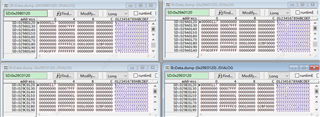

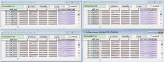

I have 16GB of memory on my board, and each DDRSS is connected to 4GB of memory. Suppose I want to enable ECC for the 0x80000000 to 0xFFFFFFFF region, the four DDRSS registers I configured are as follows:

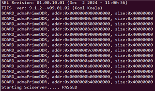

Then I write the 0x80000000 to 0xFFFFFFFF part of the known pattern through UDMA in SBL.
However, ECC errors are still detected during startup:
Is my register configuration wrong?
