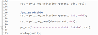

  • Hi Kim,
    Assuming tps65941_buck_val gets called in your boot flow:
    diff --git a/drivers/power/regulator/tps65941_regulator.c b/drivers/power/regulator/tps65941_regulator.c
    index ee86b8894a..bdfdc183d8 100644
    --- a/drivers/power/regulator/tps65941_regulator.c
    +++ b/drivers/power/regulator/tps65941_regulator.c
    @@ -173,6 +173,7 @@ static int tps65941_buck_val(struct udevice *dev, int op, int *uV)
            ret = pmic_reg_write(dev->parent, adr, ret);
    +       ret = pmic_reg_write(dev->parent, 0x9, 0xbf);
            udelay(uwait);
            return ret;
    Keerthy
  • Hi, Keerthy
    I applied the patch, but the symptoms seem to be the same.
    I tried to leave a log, but it seems like the log is not left in that part.
    Did I do something wrong?
    Regars,
    Kim

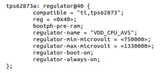

    This is enabled at R5 SPL. On your custom board are you have AVS - Adaptive voltage scaling enabled?
    If that is not enabled then this function is not called.
    - Keerthy

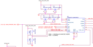

  • Keerthy,
    The schematic for AVS is the same as the Devkit.
    Is this the correct part?
    The actual i2c address is also confirmed on uboot.

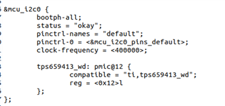

    I'm trying to proceed by adding tps65941 entry to mcu_i2c0, but it doesn't work properly.
    It seems that 0x12 device driver is not running.
    Can't there be two drivers running?
    Kim
  • The schematic for AVS is the same as the Devkit.
    So this is a standalone regulator and this does not come under TPS6594x. The slave ID is 0x48 on the EVMs not sure if its 0x12 on your custom board.
    In the PMIC probe function can you add the register write directly?
    - Keerthy
  • The pmic we use is the same as the devkit.
    So the slave id is 0x48.
    Currently 0x48 is checked in wkup_i2c and 0x12 is checked in mcu_i2c. That's why the i2c bus is different. I don't have much experience with u_boot side code. Is there a way to write to i2c bus where mcu_i2c 0x12 is?
    Kim

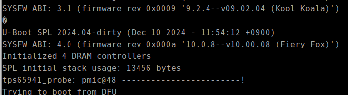

  • Hi, Keerthy
    The function is called, but it still outputs only the value 0x2c at address 0x09. This is the same value as the value at address 0x09 in the nvm.bin file.
    The value I want to change is address 0x409.
    Kim

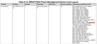

  • Hi Keerthy
    I checked the trm document because it was confirmed to be a power issue. I checked the table below.
    ti-processor-sdk-linux-adas-j784s4-evm-10_00_00_08/board-support/ti-u-boot-2024.04+git/arch/arm/mach-k3/r5/j784s4/dev-data.c
    Then, after modifying it as shown below, it seems that the 13-minute watchdog issue was resolved.
    I think I need to test it more.
    Will there be any problems with the board if I apply the above patch?
    Kim
  • Kim,
    That was the dependency on MCU_I2C0. What you have done is to initialize the MCU_I2C0 as the PMCI needs it. So this is correct.
    I hope now you are able to access the PMIC registers in the SPL PMIC driver.
    Keerthy
