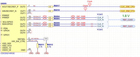

We are having technical issues with the AM6442 CPU. We use an external clockgenerator (CDCE6214) as the 100Mhz clock source for PCIe. Now we are assuming, that there is an internal pulldown resistor at the CPU side that is responsible for our problem. The clock provider is running in LP-HCSL mode and the wiring looks as follows:

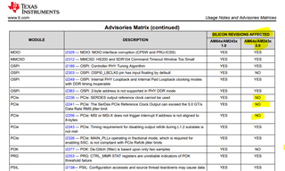

According to the errata sheet https://www.ti.com/lit/er/sprz457h/sprz457h.pdf   the SERDES Output reference clock cannot be used (i2236).
Another reason is also i2241: PCIe: The SerDes PCIe Reference Clock Output can exceed the 5.0 GT/s Data Rate RMS jitter limit

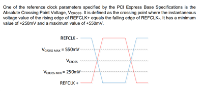

The voltage level is too low, not high enough according to the PCIe Standard (Voltage Cross).
Voltage Cross for PCIe Clock Signal:

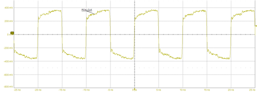

Here the signals that we are measuring, we see that we end up with a cross voltage of 200mV:

    those amplitudes in waveform do look like you experience double termination.  Normally I believe that the LP-HCSL has internal 50ohm terminations.  I was unsure if you are showing in schematic the serdes soc clock inputs as having termination resistors to gnd, but if you did that is likely where double terminated with having the clock provider in LP-HCSL mode (50ohm internal).  There is not internal resistors of CPU port W17 or W18.
    I do want to point out though that in the errata sheet, the 2 issues you mention are only issues with a Revision 1.0 of silicon.  Revision 2.0 of silicon will not have those issues.

  • Hi James, there are not termination resistors on our SERDES SOC Clock Inputs. Are you sure about your statement about the missing internal resistors? In the errata sheet the i2306 it mentions internal termination. What is that about in the current silicon version 2?
  • Hi Michael, yes I misspoke with saying there are not internal termination resistors.  If you were using PCIE as boot mode then SOC's ROM would have taken care of disabling the termination resistors for silicon revision 2.0
