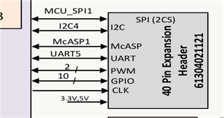

I am try add an SPI device through the 40 pin RPI header for the AM68 dev board (SDK version is 09.02.00.04). I have referred https://e2e.ti.com/support/processors-group/processors/f/processors-forum/1313556/processor-sdk-am68a-how-to-configure-spidev-for-am68a and was able to enable the spidev node but I want to know if it is possible to use the 40 pin header due to easier pin outs.
  • Hi Faheem,
    It should be possible to enable MCU_SPI1 since MCU_SPI1 is connected to expansion header. If you already have SPI set up, you would need to pinmux MCU_SPI1 using sysconfig, and use the new pinmuxed pins in the spi nodes.
    Takuma

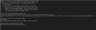

  • I got the spi node enabled as spidev1. I also want two GPIO pins for an Interrupt signal and a reset signal. But there aren't any gpio nodes in /sys/class
  • Hi Faheem,
    1. Could you check /run/media/BOOT-mmcblk1p1/uEnv.txt to make sure the overlay is added as documented?
    2. Could you share boot logs?
    3. Could you share logs from running the sample scripts?
    Takuma
  • I have added the overlay as documented
    These are the boot logs

    I want to check whether this spi node corresponds to MCU SPI1 and is accessible from RPI header. Could you confirm this?
    spidev0.0 -> ../../devices/platform/bus@100000/bus@100000:bus@28380000/40310000.spi/spi_master/spi0/spi0.0/spidev/spidev0.0
  • Hi Faheem,
    Yes, 40310000 should correspond to MCU_SPI1
    Takuma
