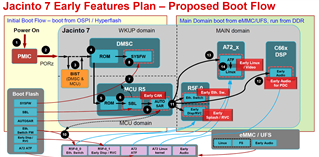

Dear TI,
About the boot mode of J721S2 TDA4AL,
I would like to have following similar boot flow
Boot both of MCU AUTOSAR(or FreeRTOS) and A72
I think i should use combined-appimage to do it, right?
Or, Are there other method?
I reference to the URL
https://software-dl.ti.com/jacinto7/esd/processor-sdk-rtos-j721s2/10_00_00_05/exports/docs/pdk_j721s2_10_00_00_27/docs/userguide/j721s2/boot/boot_hlos.html#combined-appimage
I use csl_mcan_evm_loopback_app as test app
However, i can not bootup SoC part and got following log
Do yo have any comment?
