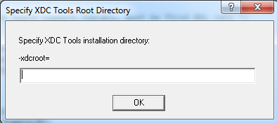

My second problem: there are various example code projects for the board on the Spectrum Digital website. Unfortunately, they were all made in CCS v3. When I import one, such as Hello2 (from the files on the Spectrum Digital website, a simple program (basically just LOG_printf(&trace, "hello world!");), and try to convert the included hello.cdb, I get the following error dialog:
Leaving it blank or entering "C:\ti\xdctools_3_22_03_41", which I believe to be the directory it is asking for, produces the same result. Namely, hitting return brings up an error dialog "Unable to Create BIOS Config Server" followed by the error dialog "Error retrieving version in file c6x1x.cdb: Failed to open file". This is followed by:

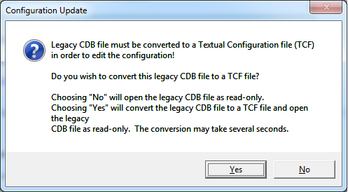

which upon clicking "yes" produces an error dialog that says "seed and app version don't match" and then that the update process failed. Then ANOTHER error:
