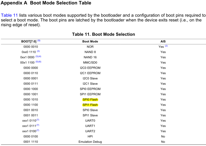

    I would like to ask another question on SPI Flash SecureBoot.
    There are two SPI controllers on OMAP L138, and I have found in Table 11. Boot Mode Selection, Appendix A, SPRAB41D, Using the OMAP-L132/L138 Bootloader Application Report (Rev. D) that bootmode pin configuration seems to support both SPI0 and SPI1 for SPI Flash boot. However, the table didn't say whether SecureBoot is supported for each of the mode above.

    Since there is no explicit statement on whether SPI0 or SPI1 should be used for SPI Flash SecureBoot, does it mean that the SecureBoot  can use either SPI0 or SPI1 Flash? Could you confirm this?
    Zheng
  • Either SPI1 or SPI0 will work.
    Regards, Daniel
