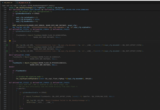

I have some questions about OSPF flash in SBL and would like to consult with experts from TI.
As shown in the figure below, in function SBL_ReadSysfwImage , reading sysfw is obtained through "SBL_SysFwLoad (void *) (* pBuffer), (void *) (ospi_cfg.dataAddr+SBL_OSPI-OFFSET_SYSFW), num-bytes);"? Where is the address data for ospi_cfg.dataAddr provided?
I read ospi_cfg.dataAddr + SBL_OSPI_OFFSET_SYSFW The data at this address did not change. I read ospi_cfg.dataAddr + SBL_OSPI_OFFSET_SYSFW The data at this address did not change. And ospi_cfg.xipEnable = 0.
LOG as follows: and ospi_cfg.xipEnable = 0.
LOG as follows:
111111111111111111 line = 205,ospi_cfg.dataAddr = 90068230.
111111111111111111 ospi_cfg.xipEnable = 0.
111111111111111111 line = 235,ospi_cfg.dataAddr = 90068230.
111111111111111111 line = 238,ospi_cfg.dataAddr = 90068230.
111111111111111111 line = 270,ospi_cfg.dataAddr = 90068230.
111111111111111111 line = 272.
