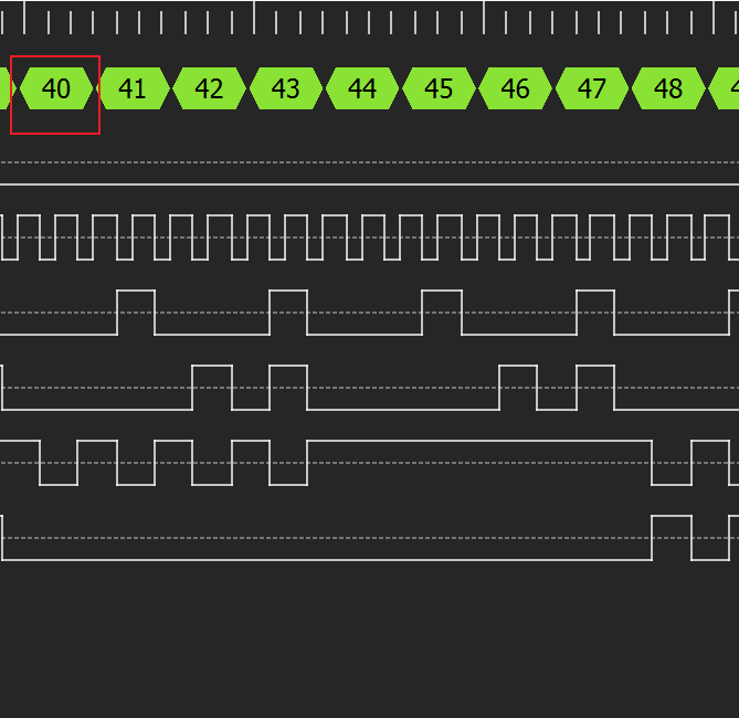

AM6421: OSPI frame is split?
Part Number: AM6421
In direct mode, the clock is 10 M.
By calling the interface as shown in the figure above, the waveform is as follows.
A frame is split into three frames.
I want to know if this phenomenon is correct?

  • Hi Vaibhav,
    The write operation starts at address 0x00 with a quantity of 0x40.
    On the waveform, it is observed to be split into three frames, in sequence:
    The first frame starts at address 0x10 with a quantity of 0x20.
    The second frame starts at address 0x00 with a quantity of 0x10.
    The third frame starts at address 0x30 with a quantity of 0x10.
    Other observations,address 0x10 is written before 0x00.

  • Hi Vaibhav,
    When writing data, you need to have a starting address and size, which may be described here as a more appropriate size。
    BR
    Ryan

  • Hi Vaibhav,
      Below waveform is captured by customer to read Nor Flash (W25Q256JVFQ 128 byte. We can see the low level OSPI controller read these 128 bytes by two transactions, the first frame is form 0x0 to 0x53, the second transaction from 0x40 to 0x7F,
       The issue is why overlap data transaction happened?  And there is no regular frame size, what's the low level OPSI controller behavior? Please response the issue directly or turn help the OSPI controller IP owner. Thanks.

  • Hi Ryan,
    When you send some bytes or receive some bytes then the frame splitting/overlapping is something to be looked for as this should not happen.
    Reason:
    For write direct and read Direct API, the implementation at low level is just a simple memcopy operation, and based on your last response, a read for 128 bytes via memcopy should be one single transaction with no overlapping.
    I have increased the priority of this issue for wider visibility and will provide response on the same when we progress.

  • Hello Ryan,
    Question for you:
    The flash configuration values are incorrectly configured.
    You have mentioned few values here: https://e2e.ti.com/support/processors-group/processors/f/processors-forum/1450567/am6421-ospi-frame-is-split/5653718#5653718
    I have checked the datasheet and turns out that the following values are incorrect for which I have written the comments in red
    Action item on me:
    Within sometime, I will probe the data lines and check for the overlapping behaviour which is unexpected.
    Vaibhav
  • Hello experts,
    To focus on the objective, here is the summary.
    Issue we met:
    • Each reading or writing was divided into several requests
    • Don't know how many requests divided for different data length of reading and writing
    • Uncertain behavior
    • Lower performance of reading and writing vs OSPI reading/writing operation.​
    Supports we need:
    • Need OSPI communication to read/write operation
      • Each reading operation should have one request sending to device
      • Each writing operation should have one request sending to device
    • Need a solution to avoid divided into several requests for each OSPI reading/writing operation.
    Let me  know if you have any question.
  • Hi Ryan,
    The following are some recommendations for optimizing transaction behavior based on register dump results.
    1 Use indirect mode to access the ospi controller
    2 With STIG enabled, we can set the number of bytes read by the STIG memory library in the current case.
    3 Refresh the OSPI controller pipe by setting FSS0_OSPI0_SS_CFG bit 3 to 1 before read and write operations.
    Please feedback  the result. Thanks.
    Linjun

  • Greetings Ryan,
    1. What exactly does this mean? Do you mean on the scope the indirect read?
    2. This register dump is missing a critical register, the Indirect Read Transfer Control Register at offset 0x0FC40060. This has a number of status bits relating to the transfer.
    Sincerely,
    Lucas

  • Hi Ryan,
    Could you please fix this small bug in the MCU PLUS SDK 10.01 for AM64x?
    Inside ospi_lld.h, on line 182, can you go ahead and switch the position of data and addr?
    So the definition should look like as follows:
    Once done, please rebuild the libraries.
    And give your code a run.
    Why this change is happening?
    The function definition should be cmd, addr, data which follows 1s-1s-4s and it sets correctly.
    But, earlier in the SDK, it is written as cmd, data, addr which will make the setting as 1s-4s-1s, instead of desired 1s-1s-4s.
    Vaibhav
  • Hi Ryan,
    I am probing the lines to check the behaviour and I will update you best by starting of the next week as I am yet to get the clock line soldered.
    Post this I will see the behaviour and let you know.
    Vaibhav

  • Hi Ryan,
    Post our call today, I am supposed to send you waveforms for the following:
    1. 1s-1s-1s INDAC 128 bytes read from QSPI NOR Flash part. (Clock: 100 MHz, Clock Divider: 4)
      https://e2e.ti.com/cfs-file/__key/communityserver-discussions-components-files/791/indirect_5F00_read_5F00_128bytes_5F00_1s_5F00_1s_5F00_1s.sal
    2. 4s-4d-4d INDAC 128 bytes read from QSPI NOR Flash part(For this we applied a glitch filter of 4 ns which is 10% of clock period)(Clock: 100 MHz, Clock Divider: 4)
      https://e2e.ti.com/cfs-file/__key/communityserver-discussions-components-files/791/indirect_5F00_read_5F00_128bytes_5F00_4s_5F00_4d_5F00_4d.sal
    3. 8d-8d-8d INDAC 128 bytes read from OSPI NOR Flash Part(I got the soldering done for the TI EVM having OSPI NOR Flash, earlier for the above two captured waveforms the soldering was done on TI EVM having QSPI NOR Flash)[NOTE: I will be sending the waveform for this in sometime]
    The waveform as seen in both of these transactions, happens in 1 Chip Select low.
    How to view the waveform?
    To view the waveform simply head over to this website and download the Logic 2 software: https://www.saleae.com/pages/downloads
    Once downloaded, you can save the attached waveforms which have an extension of .sal and then simply click on it. It will automatically open the Logic 2 software and show the waveform.
    Vaibhav

  • Hi Ryan,
    I have completed capturing the waveform for 8D-8D-8D mode, with an OSPI NOR Flash part: S28HS512T.
    The waveform is for INDAC Read of 128 bytes. The value read is 0, 1, 2, 3, 4..., 127.
    This happens with a 0xEE command sent twice, and then we read the values 0, 1, 2, ... until 127 under 1 chip select toggle.
    https://e2e.ti.com/cfs-file/__key/communityserver-discussions-components-files/791/indirect_5F00_read_5F00_128bytes_5F00_8d_5F00_8d_5F00_8d.sal
    Vaibhav
