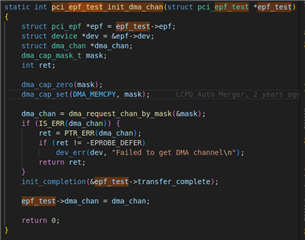

    Besides, when we configure EP device with the script as follows in SDK0902, the epf driver print messages which did not appear in SDK0805:
    We check it in the epf driver and find the difference :
    Did you encounter the same problem in SDK0902? Will it influence  DMA transmission speed?

  • Hi Semon and Mingjian,
    Apologies for the delay. Missed this forum thread. I took a look at the error message, and I do not think this is the cause of issue.
    In the 9.2 SDK, we are going to fail_back_tx:
    But in 8.5 SDK, we are doing the same thing as fail_back_tx in 9.2 SDK:
    This is because this is a new feature added by the community for using eDMA: https://git.ti.com/cgit/ti-linux-kernel/ti-linux-kernel/commit/drivers/pci/endpoint/functions/pci-epf-test.c?h=ti-linux-6.1.y&id=8353813c88ef2186abf96715b5f29b191c9a7732
    And since TDA4VH PCIe controller hardware itself does not have DMA embedded, and instead it uses the DMA hardware of the SoC, the information about "Failed to get private DMA rx channel" is printed. However, DMA should still be in use.
    Takuma
