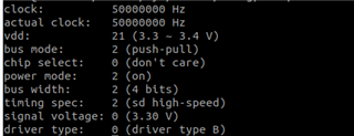

TDA4AL-Q1: How to Set SD Card to 3.3v only (low speed mode) in device tree
Part Number: TDA4AL-Q1
Hi, Dear Expert
Customer suffer from SD Boot issues, I think root cause should be SD try to swap UHS mode, but customer's SCH do not reserve circuit for 1.8v UHS.
Error logs, Customer's board

[    2.205505] Waiting for root device PARTUUID=076c4a2a-02...
[   12.407658] platform 4fb0000.mmc: deferred probe pending
[   12.412969] platform fixedregulator-sd: deferred probe pending
[   12.418787] platform 2910000.pcie: deferred probe pending
[   12.424171] platform fixedregulator-dp0-prw: deferred probe pending
[   12.430420] platform regulator-dp1-prw: deferred probe pending
Normal log. EVB

    Also Kuo,can you try applying these patches as it worked for me after doing so:
    UBOOT:
    https://e2e.ti.com/cfs-file/__key/communityserver-discussions-components-files/791/u_2D00_boot_5F00_dts.patch
    SWITCHED TO HIGH SPEED MODE in uboot:
    Linux kernel:
    https://e2e.ti.com/cfs-file/__key/communityserver-discussions-components-files/791/kernel_5F00_dts.patch
    SWITCHED TO HIGH SPEED MODE (3.3V ) in Linux Kernel:
