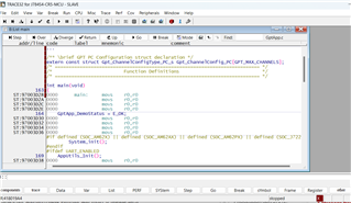

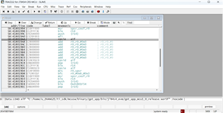

  • I built gpt_app and load it with lauterbach: ti_sdk/mcusw/binary/gpt_app/bin/j784s4_evm/gpt_app_mcu1_0_release.xer5f
    I did not get any symbol for the binary. It looks like the code is not loaded to DDR
    any scripts to load the exe to DDR usingTrace32?

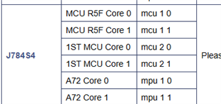

  • Another question is about the core naming convention. It is related to app the link file. What type core are those mcu 2 0 /mcu2 1 ? It just tell 1ST MCU core 0/1ST MCU core 1.
  • Hello ,
    Yes we have cmm scripts to load for using Trace 32 but please raise another query since it deviates from build issue.
    MCU1_0 and MCU1_1 are MCU domain cores whereas MCU2_0 ,MCU2_1,MCU3_0,MCU3_1 etc... are main domain cores.Based on your requirement you need to build the respective core binaries.

  • My question is MCU2_0 ,MCU2_1,MCU3_0,MCU3_1 are R5F cores ? or
    C7x cores ?
  • They are R5F cores.
