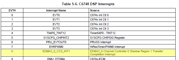

    Here's a snippet from the data sheet:
    The only EDMA interrupt physically connected to the DSP is the Region 1 interrupt.  Therefore you must use Shadow Region 1 for generating DSP interrupts.  Similarly you must use Shadow Region 0 to generate an ARM interrupt, since only the Region 0 interrupt is physically connected to the ARM.
    Thanks Brad.  I missed that in the data sheet!
