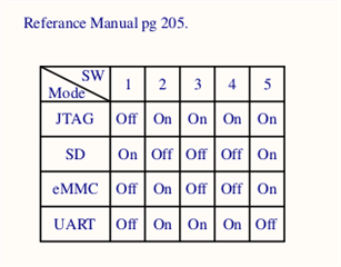

  • Hello Praveen Rao,
     Following are the boot mode pin settings for the eMMC boot in my custom board
     Thanks.

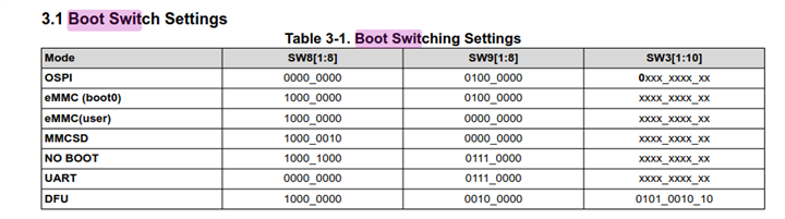

    1.Where can I find the boot switch settings for eMMC boot and UDA modes of J784S4 EVM in it's linux SDK?

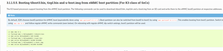

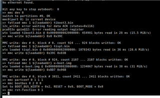

    2. I tried to boot from BOOT0 partition of eMMC.For that I have tried with the following set of commands by staying in SD card mode.
    I have calculated the block offsets and block counts based on the sizes of my individual boot files (tiboot3.bin, tispl.bin, and u-boot.img) as mentioned in attached figure.
    Could you please confirm whether altering the block offsets impacts the boot process in any way?
  • Hi Naradham,
    Its not actually mentioned anywhere in the linux SDK.However you can follow the below mentioned settings which is universal across all jacinto devices.
    Actually the block offsets from which the bootloaders fetch the code are fixed .Can you help us with the SDK version which you are using, as the offsets are different based on the version.If using 10.0 SDK version,then you can follow the below commands to copy to boot 0 partition from sd card:

         1. SDK version I am using is ti-processor-sdk-09_02_00 and pls suggest me the block offsets accordingly.
         2.BOOT capacity : 4 MiB ENH of eMMC that I am using in my J784S4 custom board.And that boot size is not sufficient If I follow the block offsets provided in TI website.( https://software-dl.ti.com/jacinto7/esd/processor-sdk-linux-j784s4/09_02_00_05/exports/docs/linux/Foundational_Components/U-Boot/UG-Memory.html#partitioning-emmc-from-u-boot)
      So, I want to know is there any way to change the size of Boot partition through software?
  • Hi Naradham,
    Actually there is no way to change the size of the boot partition as it is decided by the emmc manufacturer according to the EMMC standard.
